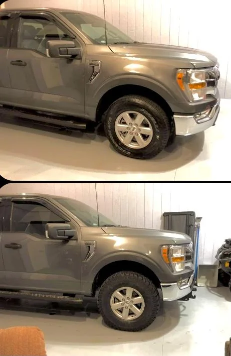

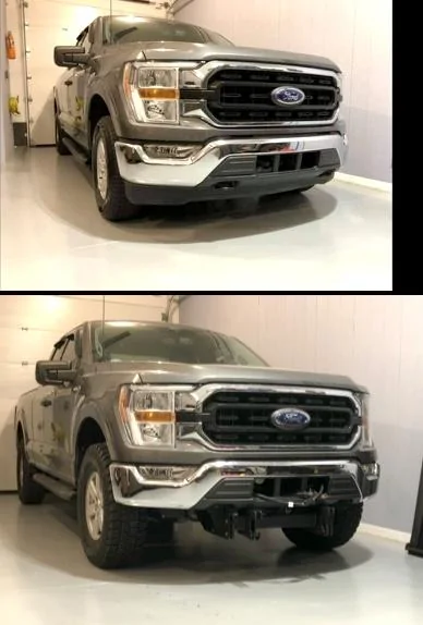

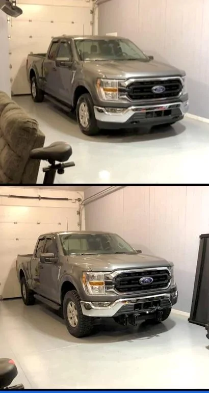

Great looking set ups! I should get my truck in the next week or two and I’m wondering if anyone can tell me if BFG KO2’s 285/75/17 will work on stock 17’s with 2.5” front level kit. I’m adding a rear leaf kit as well. Thanks!
Follow up:
Level kit and leaf installed. 285/75/17 Hercules Terra Trac TG Max(listed on Hercules website at 34.1”) fit great with no rubbing anywhere.

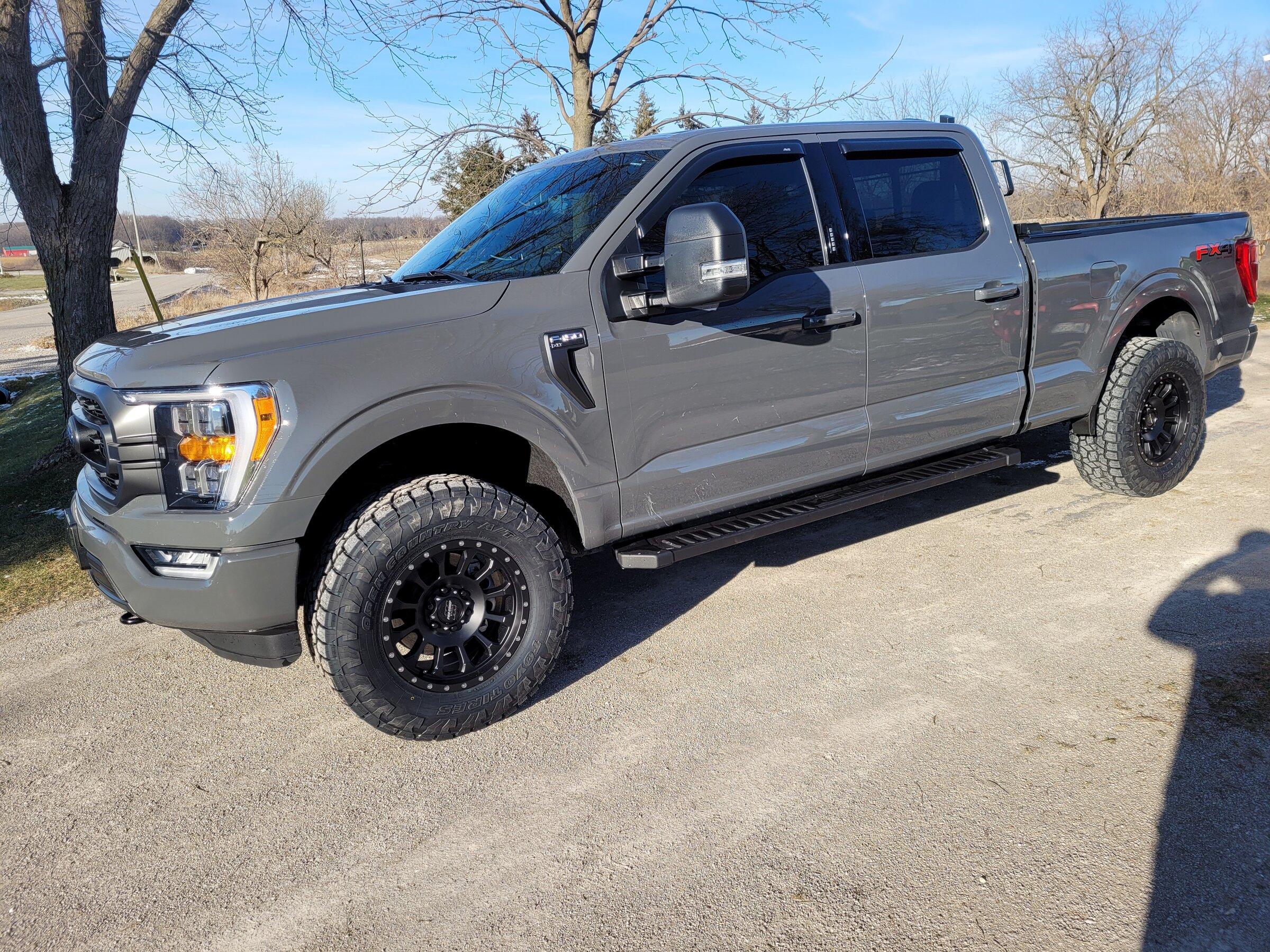

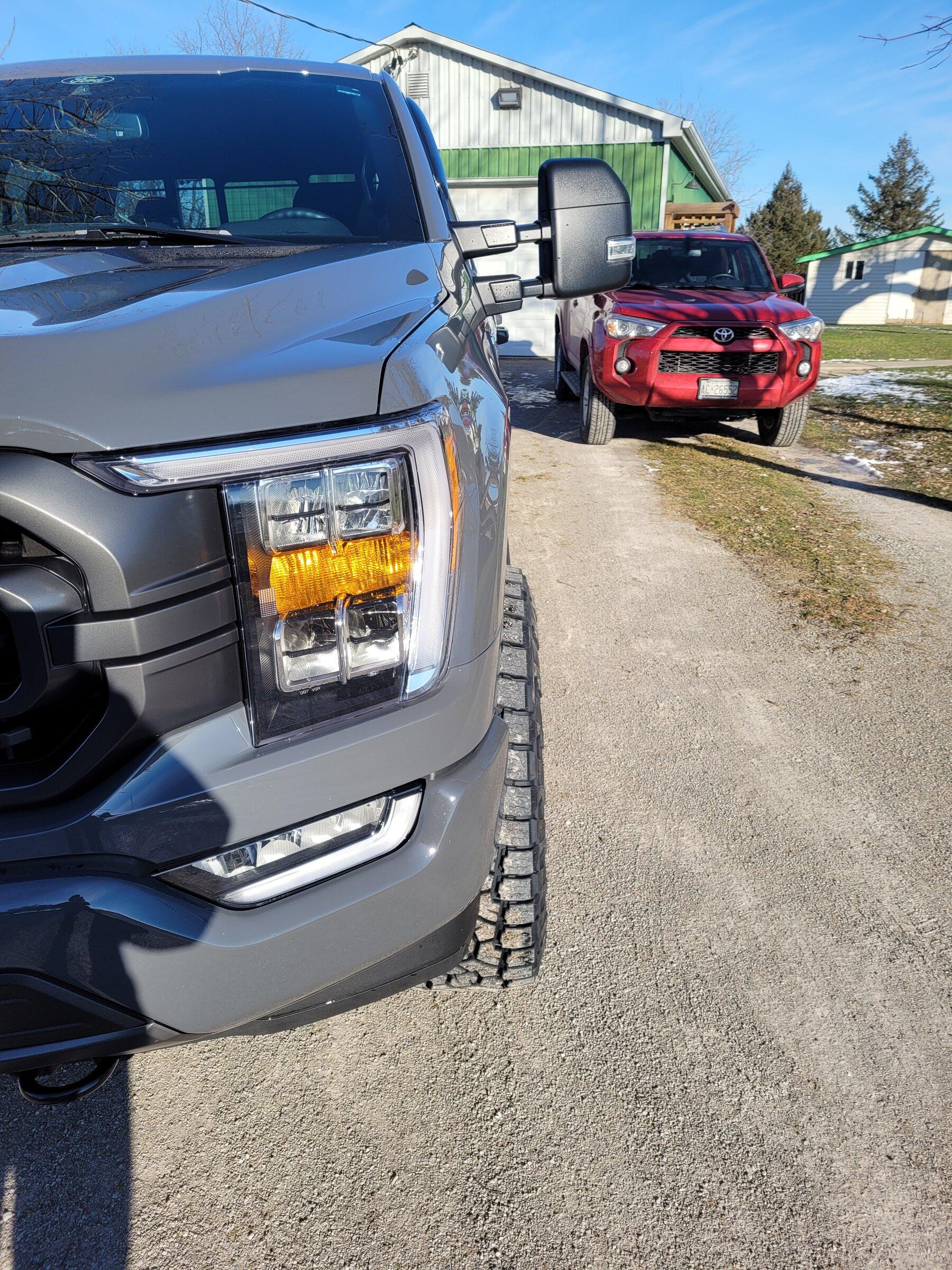

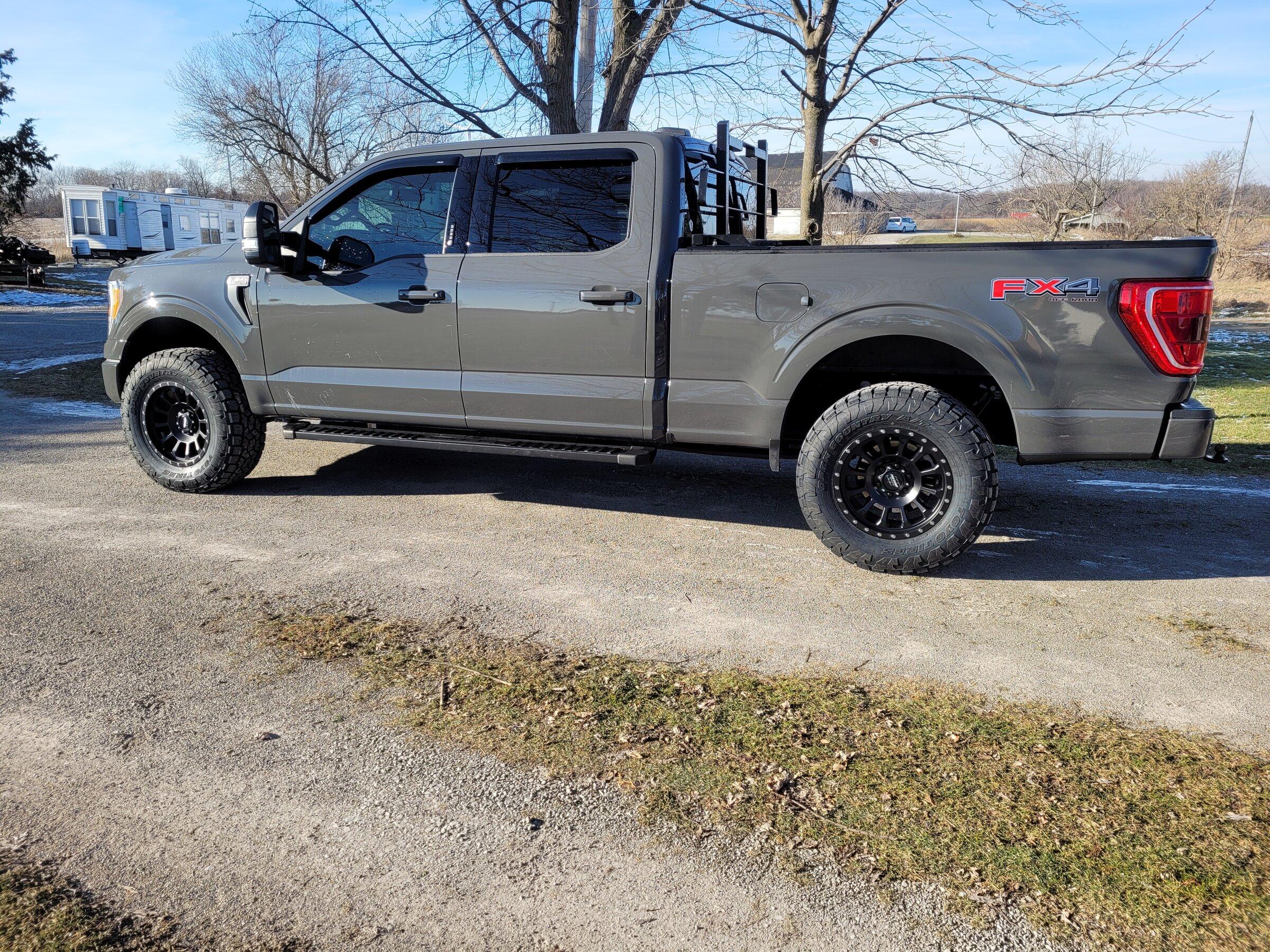

got my new setup on 305/65/18 toyo open country's on pro comp series 34 wheels 0 offset. just barely touches the front bumper skirt with a 2" level. had to remove my weather tech mud flaps on the front after they self clearanced themselves off the the driver side

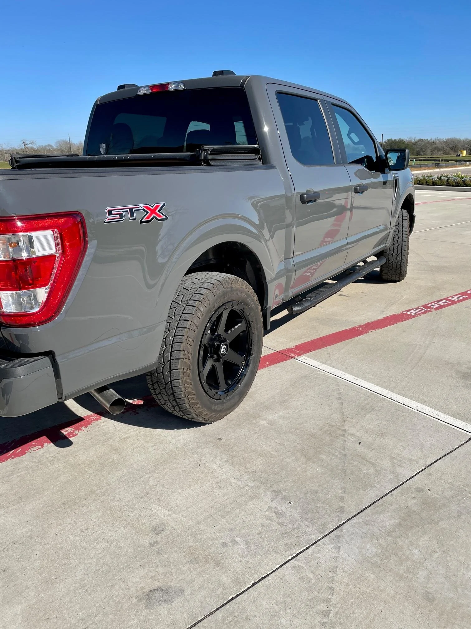

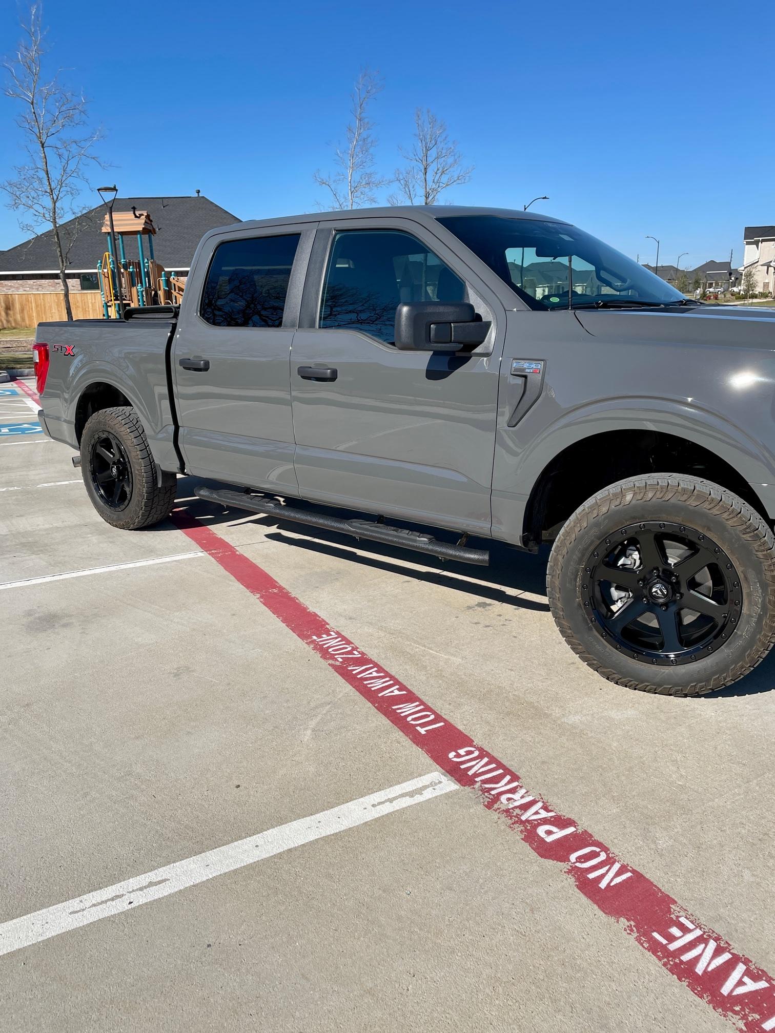

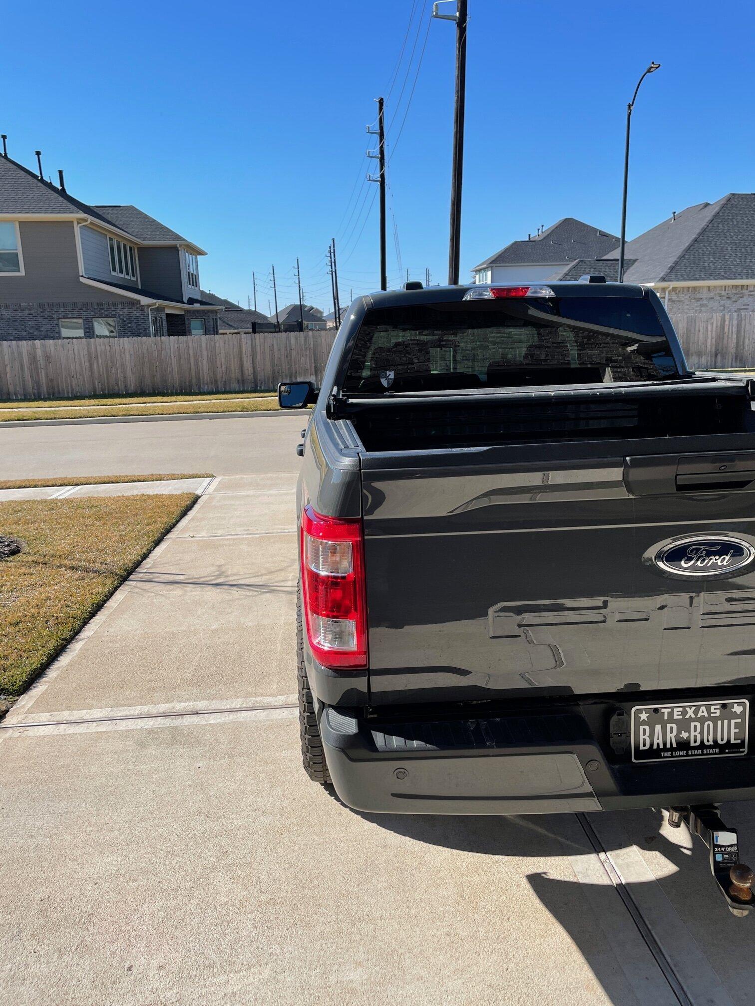

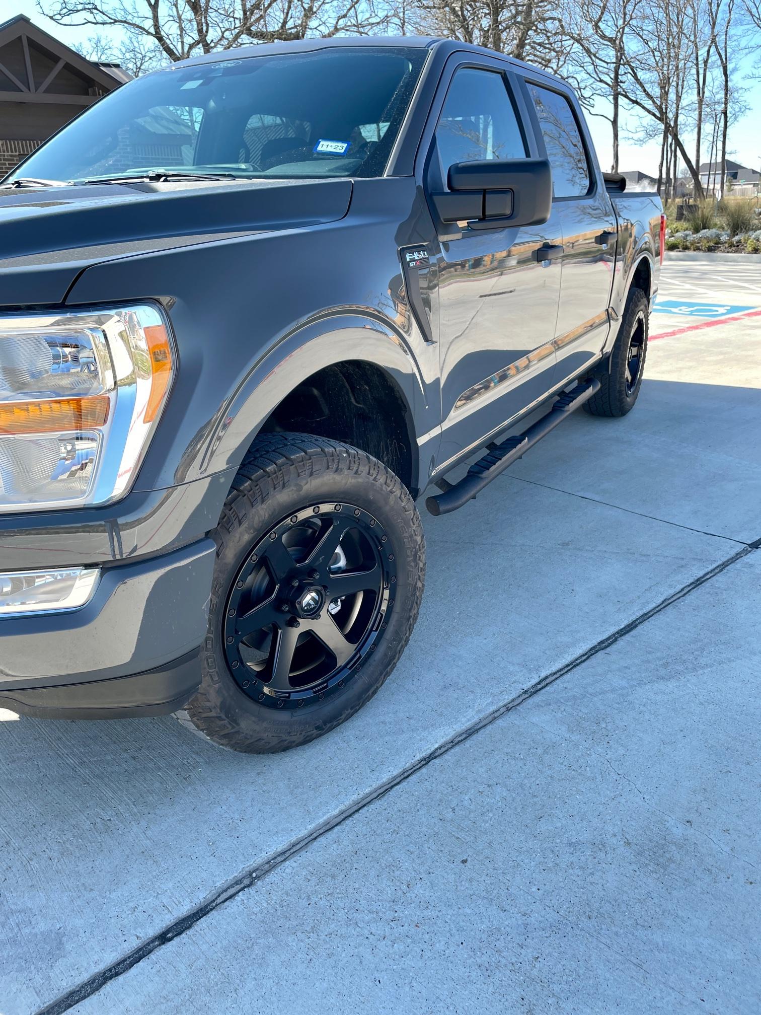

Like I said, you guys are a bad influence. I was really fixated on the new Shelby wheels, but didn't like them THAT much more than the stock STX 20s. Then I saw these Fuel Rippers and didn't hesitate. 20x9 with +20 offset, with the 275/60/20 Cooper Discoverer ATP III tires that were already on the truck. Very, very little poke. Loving the look. The truck already had the Rough Country 2" strut/shocks lift. The new wheels totally change the way the truck sits now (which I realize makes no sense, but it just looks different).
Think I'm pretty much done with this truck. Need to tint the windows and that's about it. Hopefully.

Nice truck! Great Plate!!
