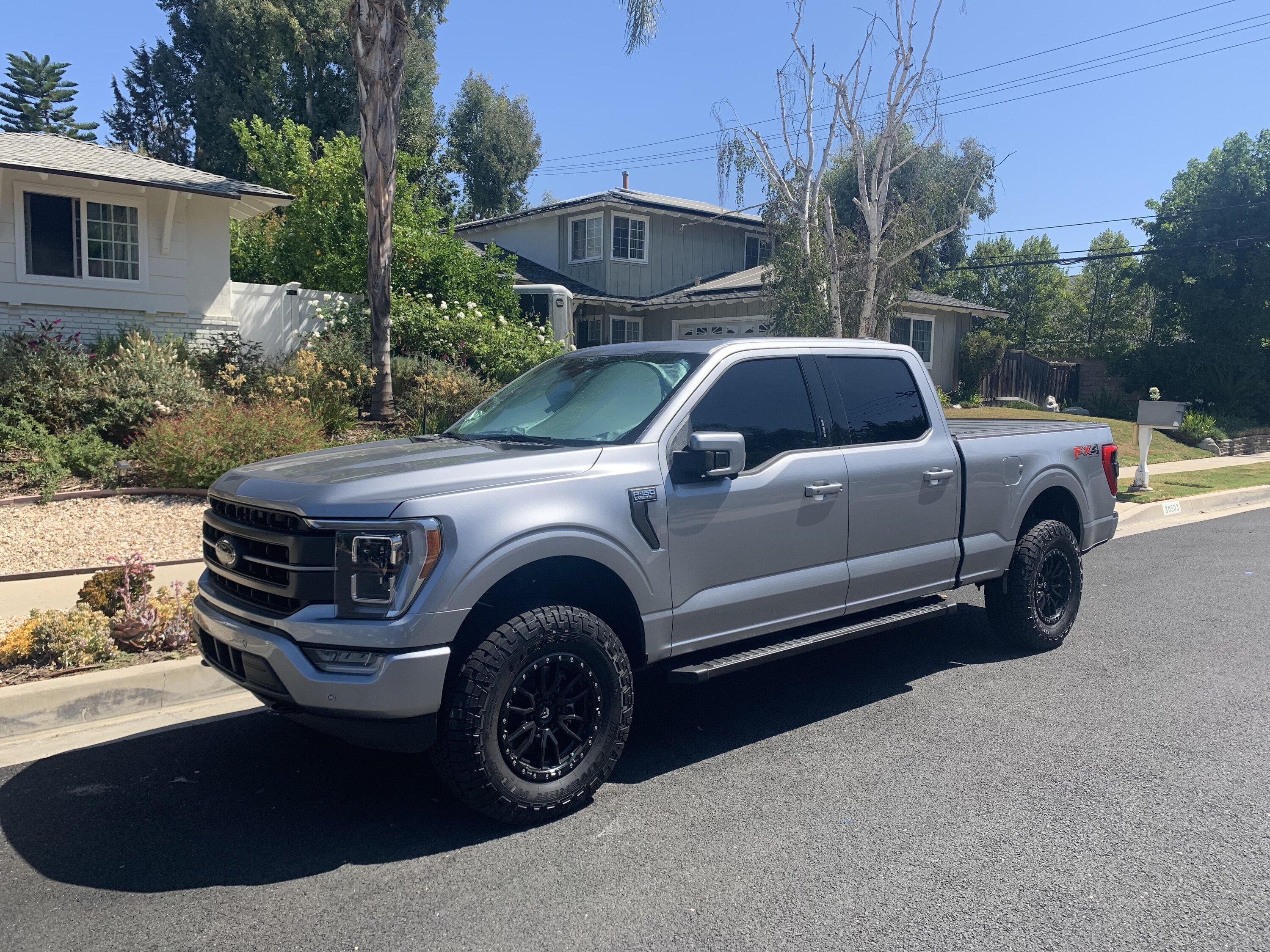

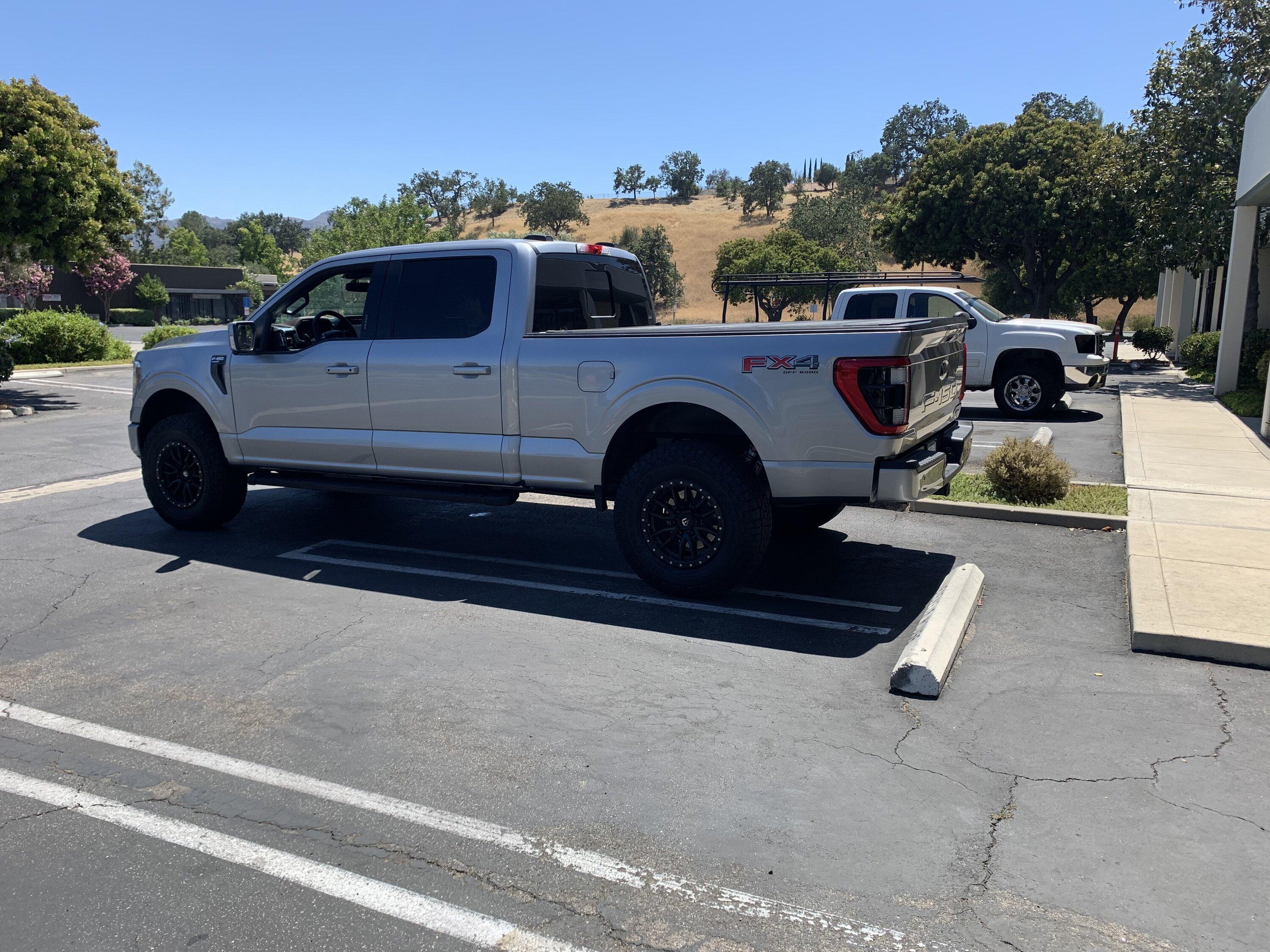

Fox 2.0 leveling kit (Cranked spring collar .5" tighter) and added another 1.5" of height to the back (3" autospring block).
22x12 XF-10 wheels (51mm offset). Nitto Ridge Grappler 33x12.5 r22
Any issues running the 12 wides? Been thinking about going with 12 wides to get that deeper dish.

Rubs the crap out of everything. Doesn't touch the rear crash bars, but rubbed on the little black plastic tab and flange back there.
The biggest problem is they rub on the back of the bumper, trimmed that up a little bit, but still rub. Also trimmed the front crash bars. If I did it again, I'd go with 10" wides.
