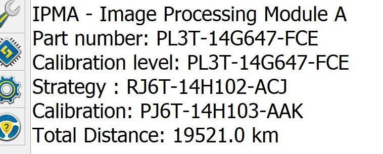

I think it's the value we see as DID F188 in FDRS?
Ford F-150 ECU module programming guide using FDRS Screenshot_20250105_203055_OneDriv
So is Forscan rendering the F188 value as
Part Number?
Calibration level?
Strategy?
Calibration?
I am just spitballing. The gurus around here will know.

Quick question and sorry if it's been asked before: when we refer to "BBC" as the software version, is that one of the things I can see in FORScan for the IPMA? Mine below (lane centering no issues):
I think it is the strategy line which on your screenshot is showing ACJ.

If I remember correctly...last time I compared my As Builts to Forscan...it was the Strategy in Forscan that matched F 188 on the As Builts

I did any way....
Previous version was ACJ
FDRS as of Nov 9, 24 PTS as of Nov 13, 24 Forscan Nov 9,24 all show RJ6T-14H102-BBC

If you want a more expansive view of your module programming, you can also download your as-built data directly from motorcraftservice.com and open it with an XML reader. The IPMA will look something like this:
<NODEID>706
<F10A>ML3T-14H106-EFE</F10A>
<F110>DSPJ6T-14G647-AG</F110>
<F111>ML3T-14H107-FF</F111>
<F113>ML3T-14G647-NA</F113>
<F120>PJ6T-14H102-MDG</F120>
<F121>RJ8T-14H102-TBA</F121>
<F122>RJ8T-14H102-GAB</F122>
<F124>RJ6T-14H103-BBA</F124>
<F125>PL3T-14H103-BBN</F125>
<F127>RJ6T-14H103-GAA</F127>
<F129>ML3T-19G490-BC</F129>
<F12A>ML3T-19G490-BB</F12A>
<F12B>ML3T-19J220-AB</F12B>
<F12C>ML3T-19J220-AB</F12C>
<F16B>ML3T-14H310-EDD</F16B>
<F17F>1AA156IO</F17F>
<F188>RJ6T-14H102-BBC</F188>
<F18C>ECUR2107902169</F18C>
<F1DC>SL3T-14H103-GDC</F1DC>
<F1E0>PXML3T-14G647-AA</F1E0>
<F1F3>28741964</F1F3>
</NODEID>
