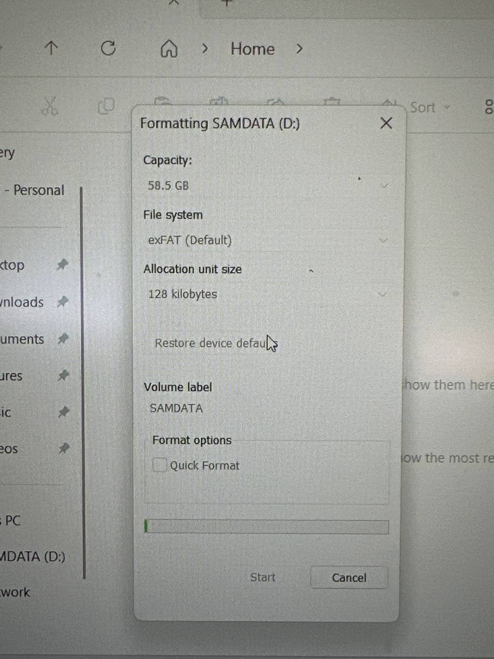

What do you mean by fully format? My usb came with exfat as a defalt. I just unclicked quick format.
That is a full format, by unclicking the quick format option. It will take a little bit, but help ensure you don’t have any bad partitions or issues with the drive.
If you still have issues, I would recommend a different usb drive. Sometimes some of these drives have issues for no reason but trying a different brand seems to make the truck happy
Volume label “SAMDATA” is too long. Reformat the drive (Quick Format is fine) and rename it something shorter—four characters at most. Or leave volume label blank. That’s what I do.

The last time i renamed the usb I named it ford and quick formatted cg. Since I’m fully formatting it now should I cancel and rename it or let if fully format then rename it ford
Something didn’t take because ”SAMDATA” looks like a default name from the factory. Try leaving the volume label blank when you do a quick format and make sure there’s no name in the volume label before attempting to use it with FDRS.
Name needs to be Ford or SYnc. Long names do not work well

10-4 I’ll rename to ford once it fully formats
No need to wait. You can abort the long format and go right to quick. Name it anything you want, just keep it to four characters.

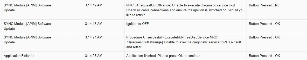

I did the quick format before on another usb and I named it ford and after I plugged the usb in and turned on the truck for 20 minutes it never registered. When I clicked yes and turned off truck it registered it but everything on my laptop failed
Try a different USB and start from scratch. Sounds like your truck doesn’t like the one you’re using. There are performance differences among different brands. I’ve had good luck with the Sandiscs that work with USB A and USB C.
What Sync version are you on? That could also be a problem since you have a 2021.
Did you see any specific USB error code on the touchscreen when it failed?
@Jesse-Infotainment Or anyone: This is what vehicle history shows in FDRS as the failure message:

Also no sync error it recognized it after I shut it off then that’s it
