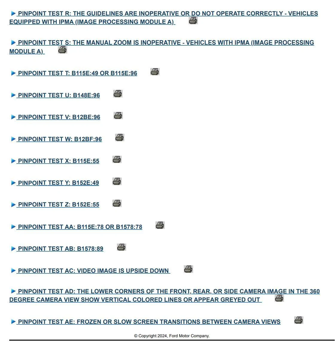

I am not sure what direction to point you in, but I did in search in PTS for B1578 and it pops up in section 413-13B of the workshop manual. See attached. The code is referenced toward the bottom and calls for the 360 alignment to be done which I know you did. I guess skim through it and see if you find anything helpful.
This pdf doesn't show the actual tests of those codes, missing data. Clicking on them doesn't do anything.
Lmk which ones you need and I'll get them for you tomorrow.

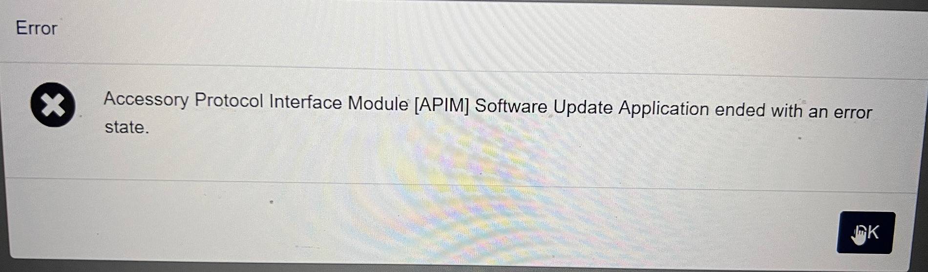

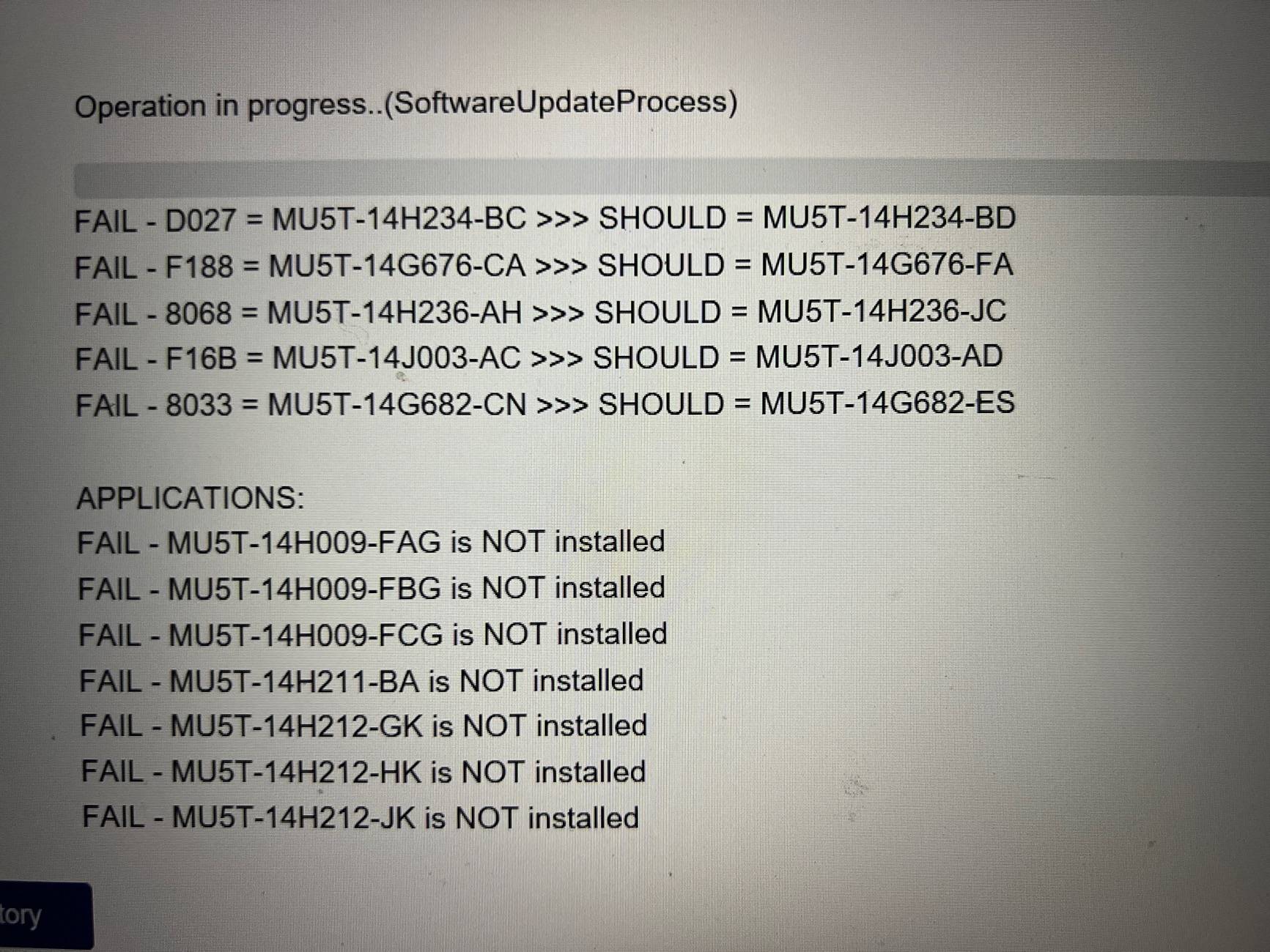

Tried the APIM update on my 2021 today, which has never received an update. After running the updates on FDRS, downloading onto USB (exfat format), and prompted to insert USB into truck, FDRS runs its scan and returned these…
Is this normal or did I screw up somewhere?
you have to wait for the truck to tell you the USB was successful before telling FDRS to verify. Maybe you did that part, but you didn't say it.

Put USB in and wait. It takes up to 10 minutes for it to pop up on screen that it is doing the update. Wait for it to finish. Then turn truck off and open driver door so everything turns off. Plug the USB in laptop and do next step in FDRS to verify.
**If you are on the broken APIM versions you'll need USB in truck for several weeks to install.
USB should remain in truck until it tells you to take it out after following the steps and it will eventually prompt you to take out stick and follow what FDRS tells you to do next which would be to click yes on computer and then it will read and see if it took the update or not.
