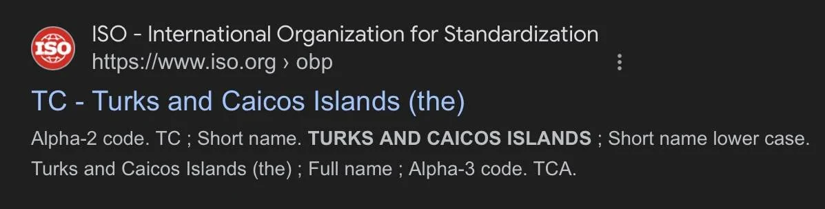

For all, country codes are ascii (American Standard Code for Information Interchange) codes. Whenever you want to know a country code, Google "ascii x" of each half of the code. E.g. ascii 54 = T, ascii 43 = C. Then Google "country code XX"; therefore TC =:
Ford F-150 ECU module programming guide using FDRS IMG_4973
Close, but no cigar ? (not having a go at anyone, Just explaining ?)
