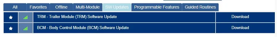

Looks like there is a new TRM update in FDRS....
Ford F-150 ECU module programming guide using FDRS 1723936859690-ij
I saw this first pop up for the 24 expedition so it seems to be rectifying a long-running issue.

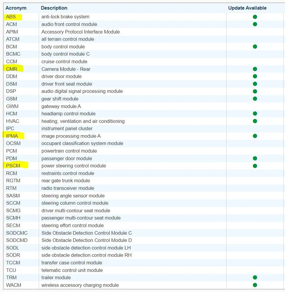

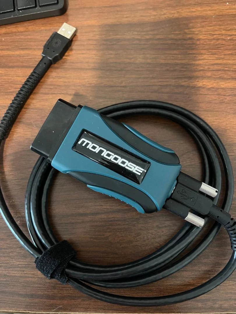

Well I'm tired of waiting on OTA although my OTA experience has not been that bad. I am wanting to try and activate the newer version on Blue cruise on my 21. I plan on keeping this truck for awhile and twice in the last six months I have had to pay to get updates done on the 21 Expedition due to issues with it so I decided to just buy a mongoose adapter and learn FDRS.
I have read through a lot of this tread but not the entire 895 pages.
Can someone give me an idea of how many updates I'm looking at?
Any words of advice?
VIN 1FTFW1E55MFA36093
Ford F-150 ECU module programming guide using FDRS mongoos
You can update them all, but you need a 15a battery charger and these updates to update your BC

@FI300 there is an ongoing problem with FDRS right now, you will not be able to update the BCM due to a login credentials error in the FDRS program. You will be able to update all other modules as at @HammaMan has listed for you.

Thanks, I have seen the messages about the credential requirement for the BCM update. I have a charger, I actually had the one recommend in the first post.
Which USB port are you guys using for the updates that require USB, the USB-A or USB-C
