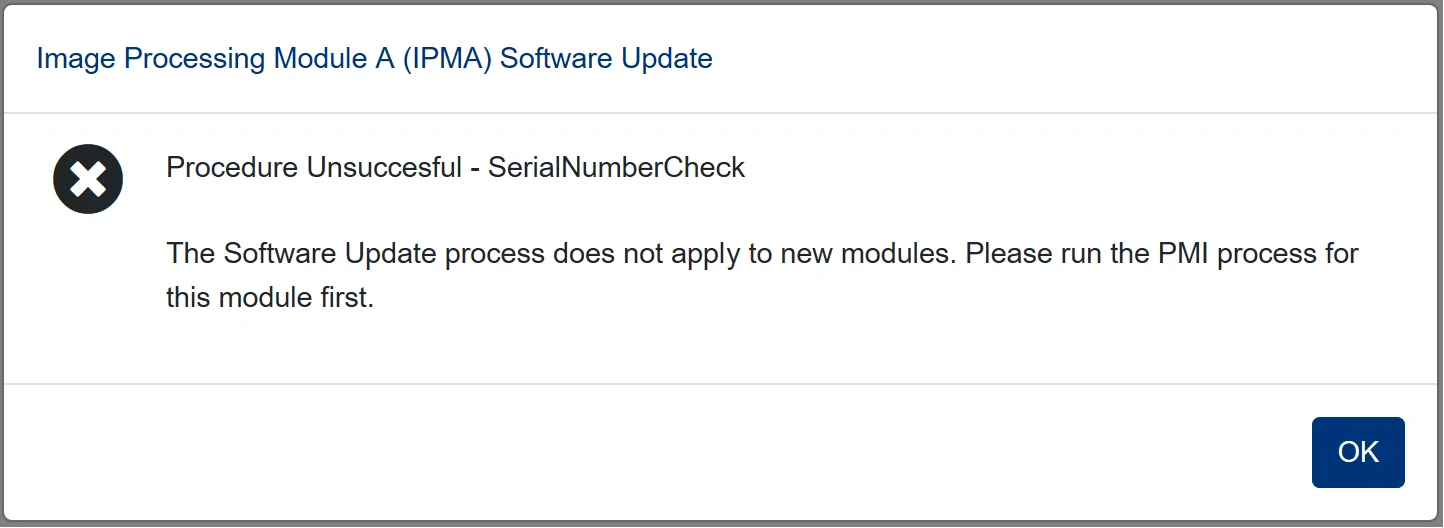

I almost made it through. I updated a chain of GWM, APIM, IPC, and TCU until all of those were gone. I only had one hiccup where as it was validating the updates and showed about 8 "Pass", all of a sudden it had a failure. I chose the option to run the validation check and everything passed.
I am stuck though. I had an update on PSCM that also would run the IPMA update. It finished the PSCM, and when it started the IPMA, it said the batter SOC was too low. It said it could continue but might fail the update, or I could cancel. I cancelled, bumped the amps on the charger up from 10 to 20., did some other updates while the battery charged up.
The PSCM module shows Gray in FDRS and one update is left for IPMA. When I run the IPMA update, it finishes quickly and tells me the following error. I do have a IPMA from Ebay that was PMI'd and configured for auto park assist. I'm not sure if that is the problem or it is because it didn't run the IPMA update along with the PSCM update. I'm thinking this will need some help from @Jesse-Infotainment.
I'm done for the night and will try again in the morning. I haven't driven it yet, but it does have power steering and it does not have any check engine lights on the dash.
