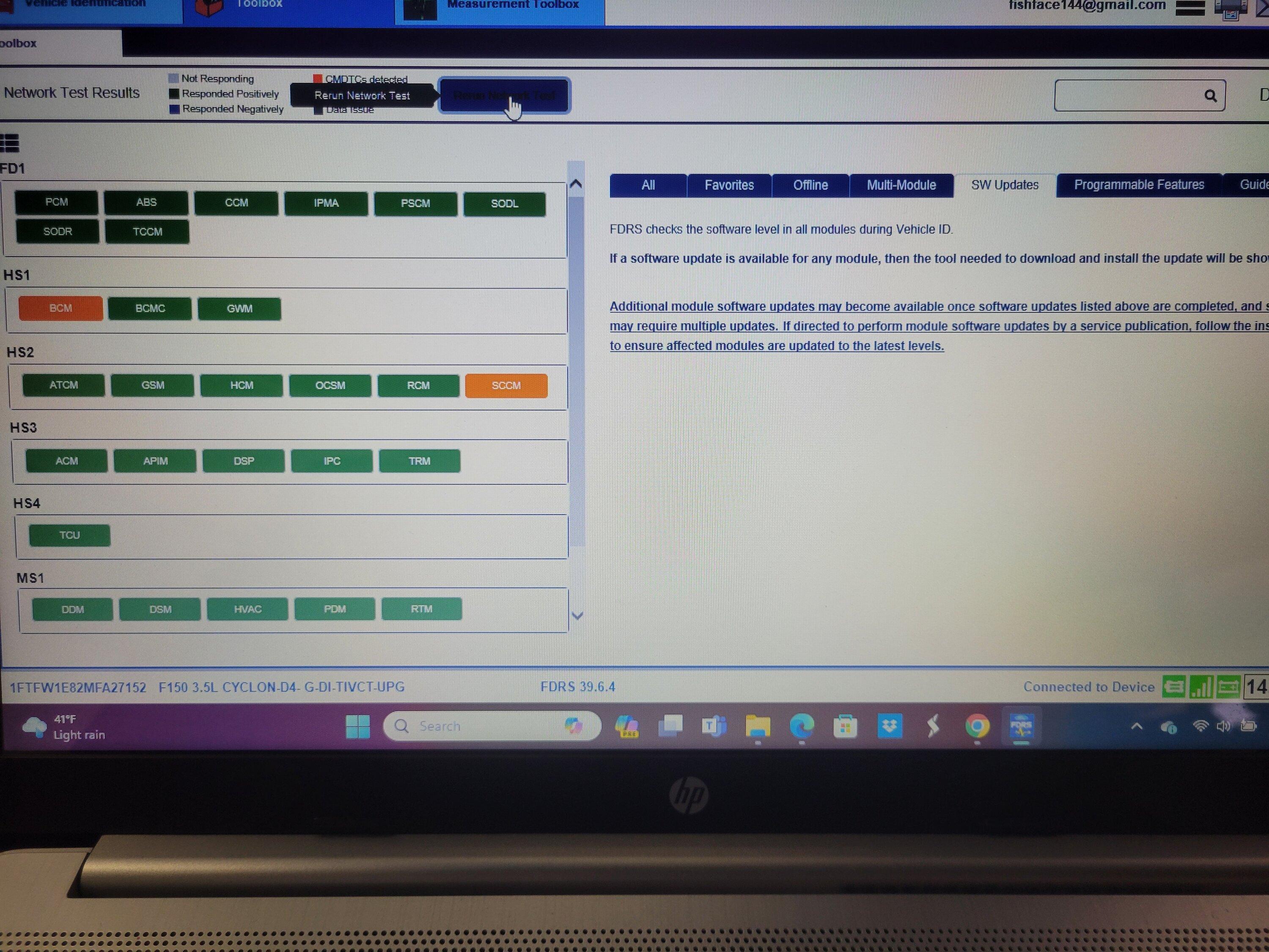

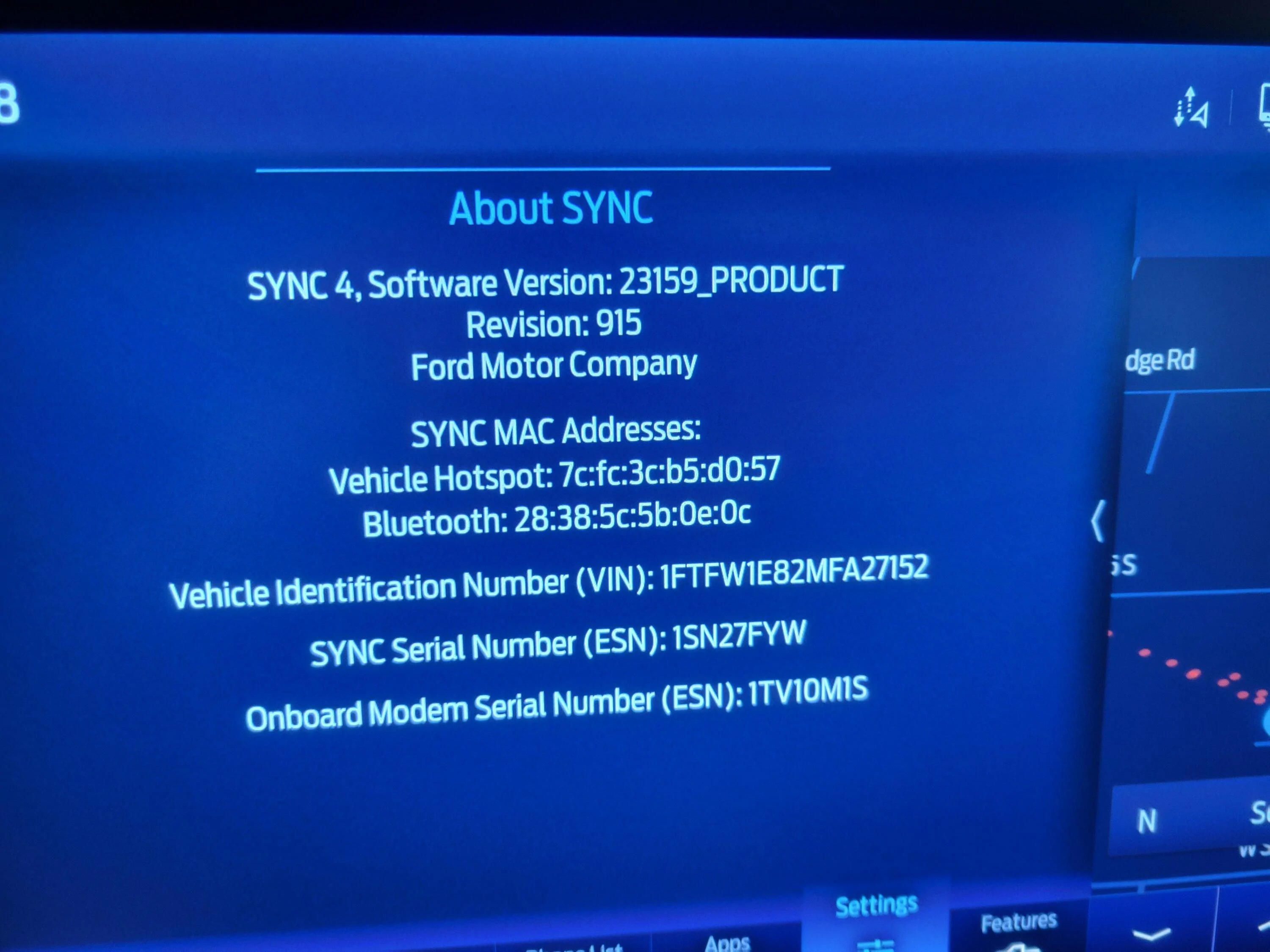

I tried the ignition on/engine off a few times, then I tried the engine running a few times and it stayed the same. However, when I logged back on, and before running the test again, nothing was gray, but the Bcm is also now orange.
The current version is 23159 and revision 915.
Any thoughts? Thanks.
