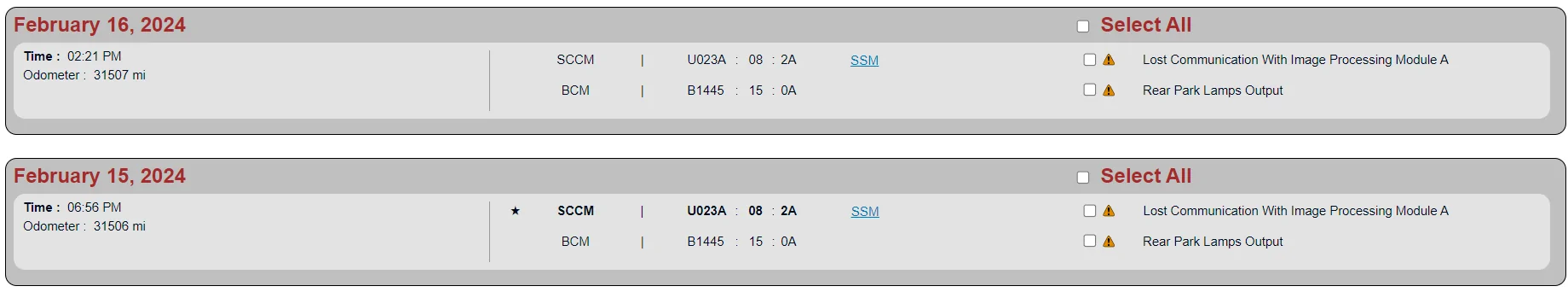

The DTC's being reported to the cloud are below:
Ford F-150 ECU module programming guide using FDRS 1708120443188
The BCM one is old and your truck was showing it prior to you updating. The SCCM has an SSM next to it telling Ford dealers to disregard it until a fix comes out later. Looks to me like you can disregard both.
Your truck is not on the latest Sync version and you are not showing any more updates in FDRS. This is an issue affecting many owners of different Ford vehicles right now. The problem is on Ford's side and is not due to anything you did wrong. Ford needs to release the rest of the updates to the server before you will be able to do them.
