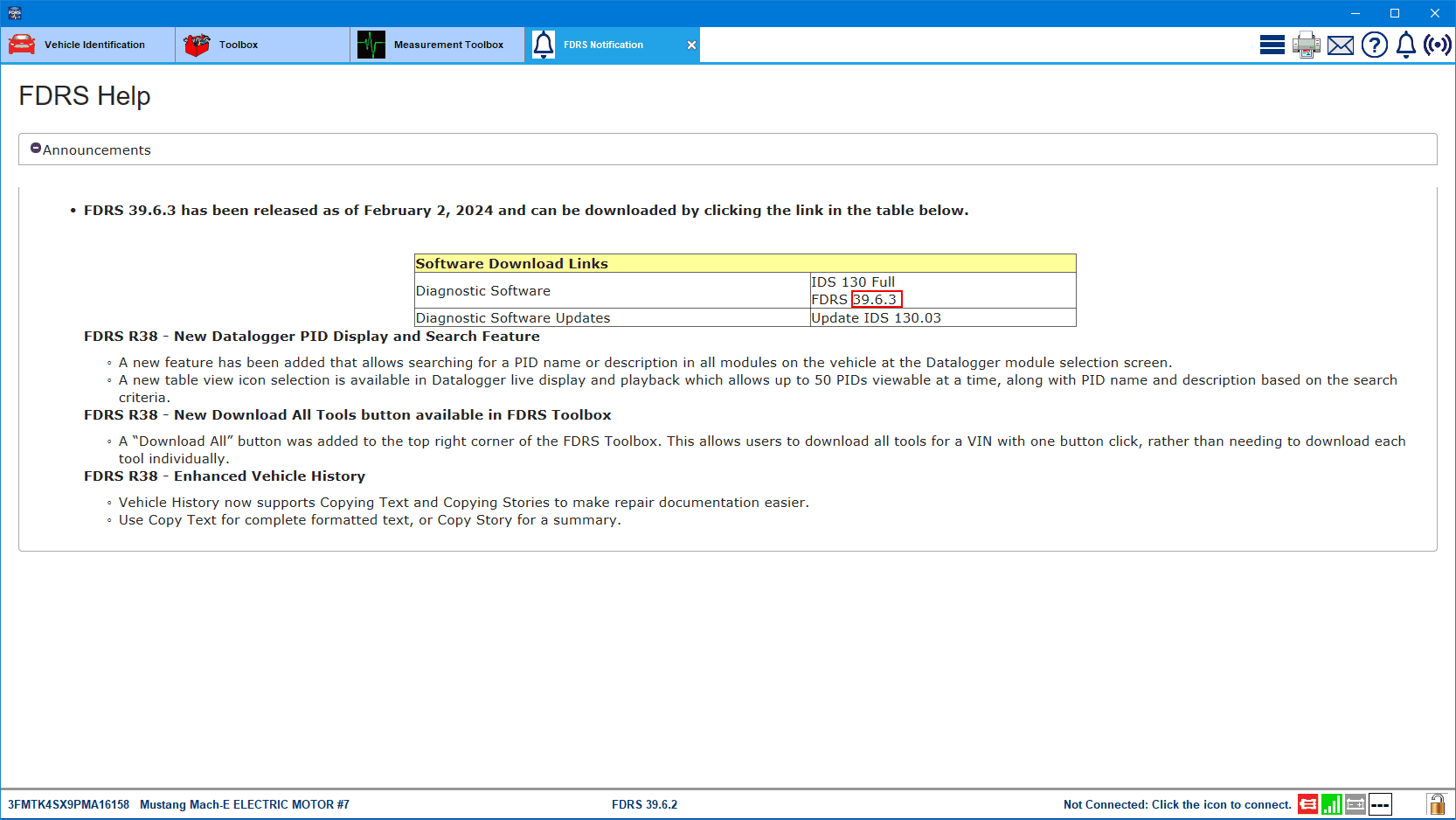

I was about to post, the notice in FDRS says that the latest version is 39.6.2, but when you download it from Ford's website and install, it's actually 39.6.3. I don't really care as it's working fine so far this morning (after I reset my password).
Ford F-150 ECU module programming guide using FDRS FDRS_39-6-3
I noticed this when I saw the little alert thing in the top right corner this morning. I guess I need to install the newer one now. I did the IPMA on my Lightning and Mach-E using the 38.5.7 revision of FDRS about a month ago and had no problems on either of those. This is the IPMA update that includes the newer BC functionality (even though it requires updates to other modules to activate it).
