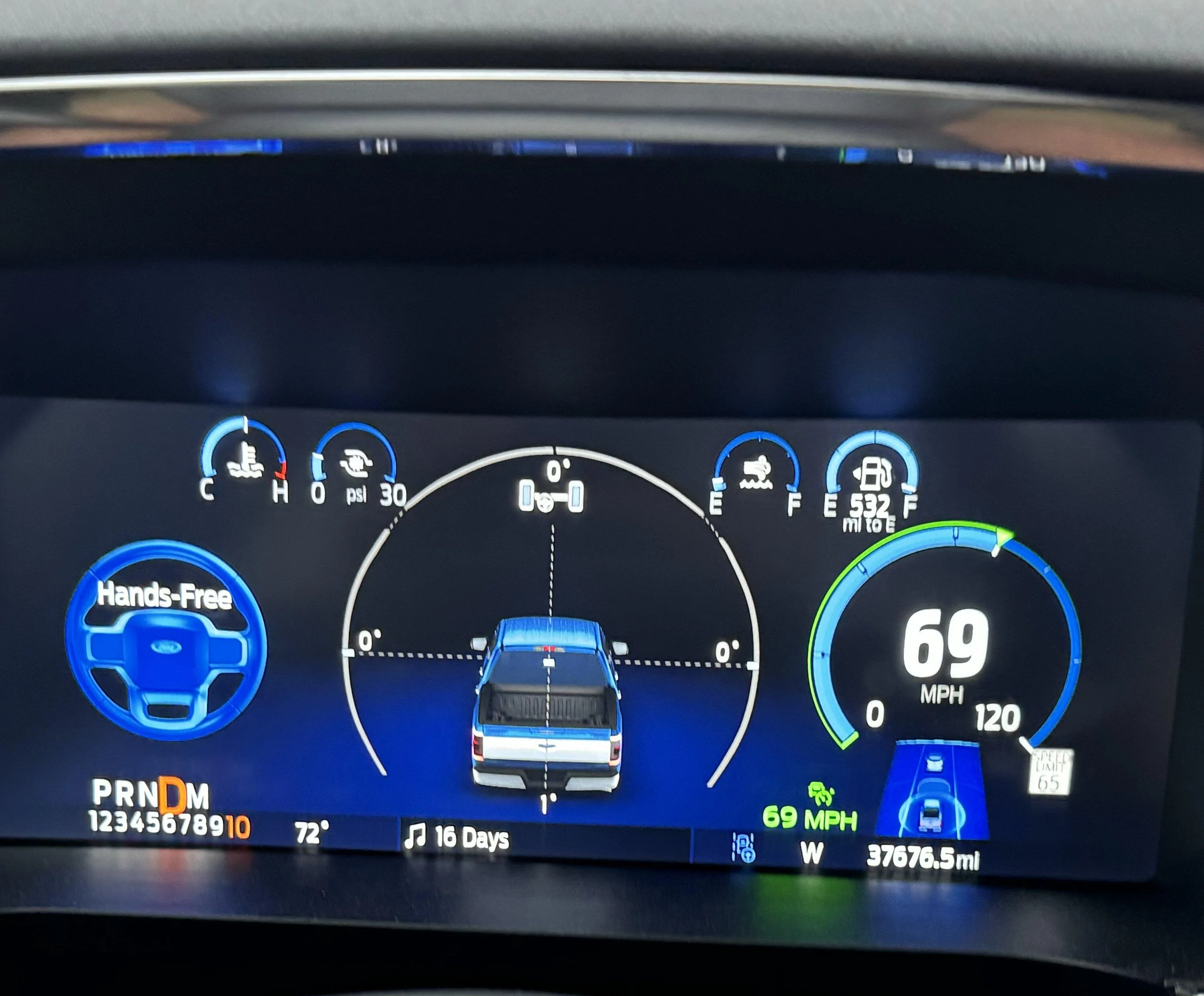

I've seen pretty decent changes in BC behavior with the new software stack. It holds all of the narrow roads it'd typically release on previously. I still have a few spots I need to play with it on yet.

With the latest updates, does BC still try to snuggle with 18 wheelers in the lane to the right? ?

My truck is staying pretty well centered in the lane now with whatever BlueCruise version it is running. I never used it before because it always looked like it was going to crash my tow mirrors into the truck on the right. I didn't pay to extend my BlueCruise and it expired but it is suddenly working again without a subscription.
