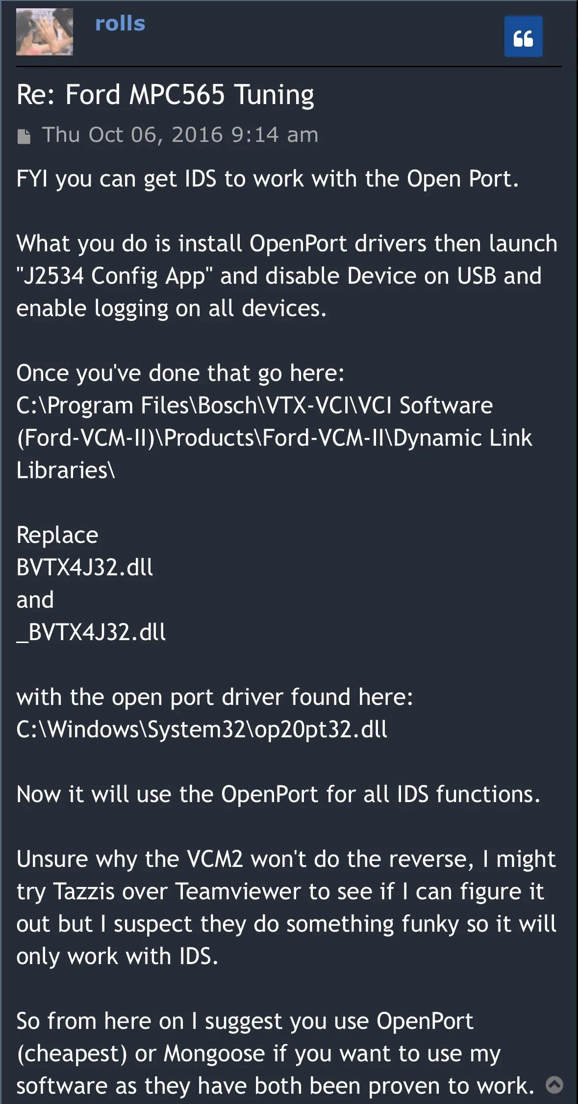

Others have gotten their Mongoose to work with IDS by replacing the USB drivers. I haven’t tried it, but I thought it was confirmed as possible a few years ago.
I’m assuming that if a guy does this to use IDS you would then have to revert it all back to them use FDRS?
Hard to say. Rotunda devices (VCM2, VCM3, etc.) will work on FDRS. If these driver changes trick the system into thinking the J2534 is a Rotunda device, maybe it still works. I don’t know. This hack is almost eight years old. If it’s solid, there should be more out there talking about it.
