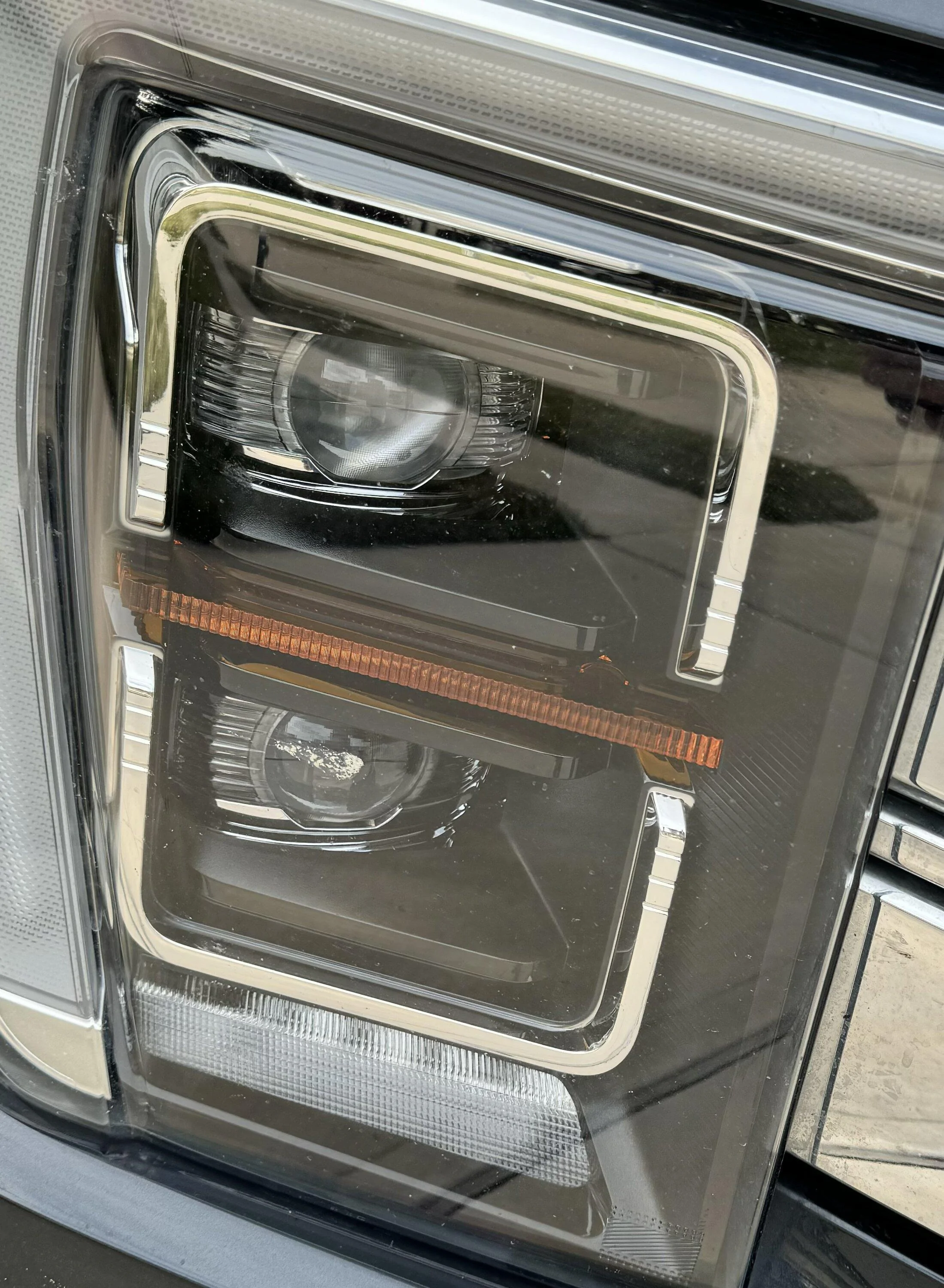

Maybe my interpretation of quad is wrong. There’s two on each side.
Well, you are technically correct, there are 4 LED's. On the lower trim models they have 4 led per headlight. You have the projectors which throw a brighter beam

Its only to prevent confusion. thats all. nOT TRYING TO MAKE A BIG DEAL BUT THE QUAD led HAVE ISSUES WITH THE UPDATE. Someone may read that abd think its ok to run the update.
