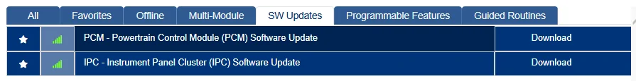

A new IPC update just just dropped for my 2021 F150 XLT (302a) 5.0L
You may hold off on that. THat update doesnt make any sense. It would be rolling you back quite a bit.
THe update files are
188 - ML3T-14C206-DAD
124 - ML3T-14C205-BAE
Current software
188 - NU5T-10F906-GAB
124 - NU5T-10F902-GAB
I checked several 21s.. THey all have it.
This software came out in 22. So its really strange. Not sure what the plan is. They are not new
Current software
Copy that!!!

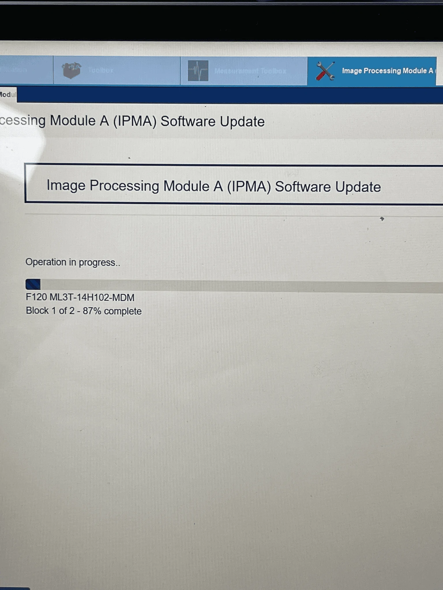

ok well another 3hrs watching the laptop screen for this...... it did drain my battery to death almost , after it installed it did a test run of modules and all passed, then it said it failed I'm guessing from a almost dead battery not able to turn on the cameras maybe? but i left charger on it , actually got a 5amp and put that on had a 2 amp which wasn't smart. but after battery has at half charge it turned over the truck drove to dinner and all seems fine looked at 360 and other cameras including the bed camera which functioned ok. Think I might upgrade the battery tho. still have like 2-3 more software updates.
I had to cave and get a dedicated power supply. I just couldn't take the inherent pucker factor of flashing paired with seeing the voltage fluctuate when all the modules cycle. I ended up getting a PowerMax PMBC 100 Amp and it even spools under load at times during these flashings. I really wanted a Schumacher INC100 DSR, but it was too much $$$.

It's a worthy investment to look at getting IMHO. I've also used my friends Clore Automotive PL2320 power supply. It worked fine, but even it can't hold the voltage stable like the PowerMax can.
