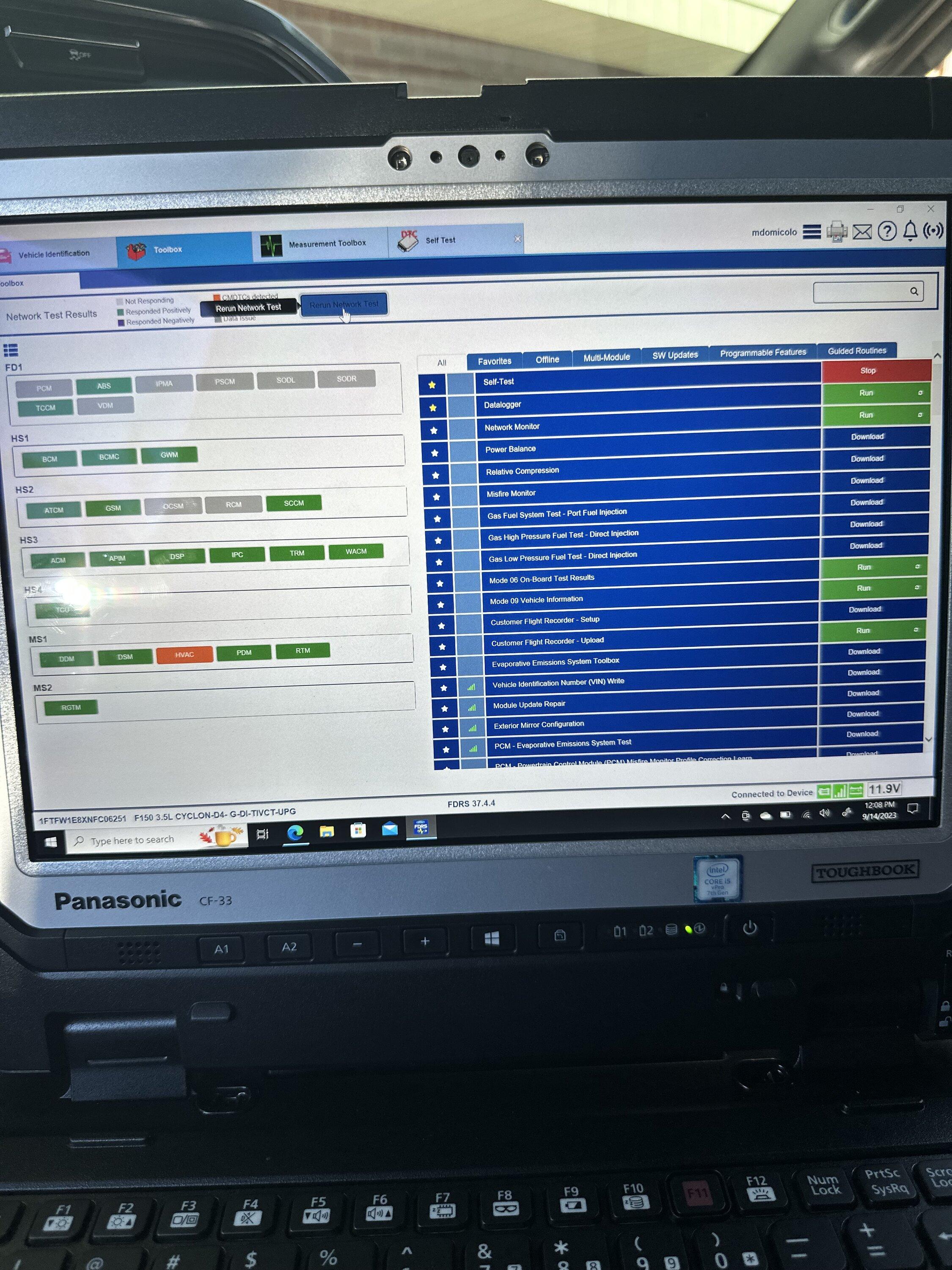

They ended up sending me a new keyboard for the Toughbook and all is well. Got onto FDRS for the first time today. Only did one small update for the wireless charger just to test it out.
i bought the recommended battery charger from Amazon, but it doesn’t come until tomorrow. My battery voltage was 11.7 after a while so I didn’t wanna push my luck.

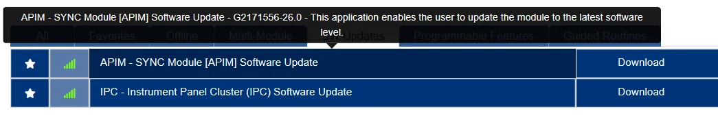

Anybody out there with a 23 have a new APIM update?
Ford F-150 ECU module programming guide using FDRS 1694728244530
I've been checking on and off the last couple weeks and was up to date, then saw these two for today. I was in line (update wise) with another 23 truck I was keeping an eye on (we were up to date). However just checked it as well and it only has the IPC update, no APIM.
Yea, it's been going around. It was first reported a few weeks ago and is being pushed out OTA, as well. Brings your Sync version up to 23159, but no new goodies in it except and updated owner's manual.
