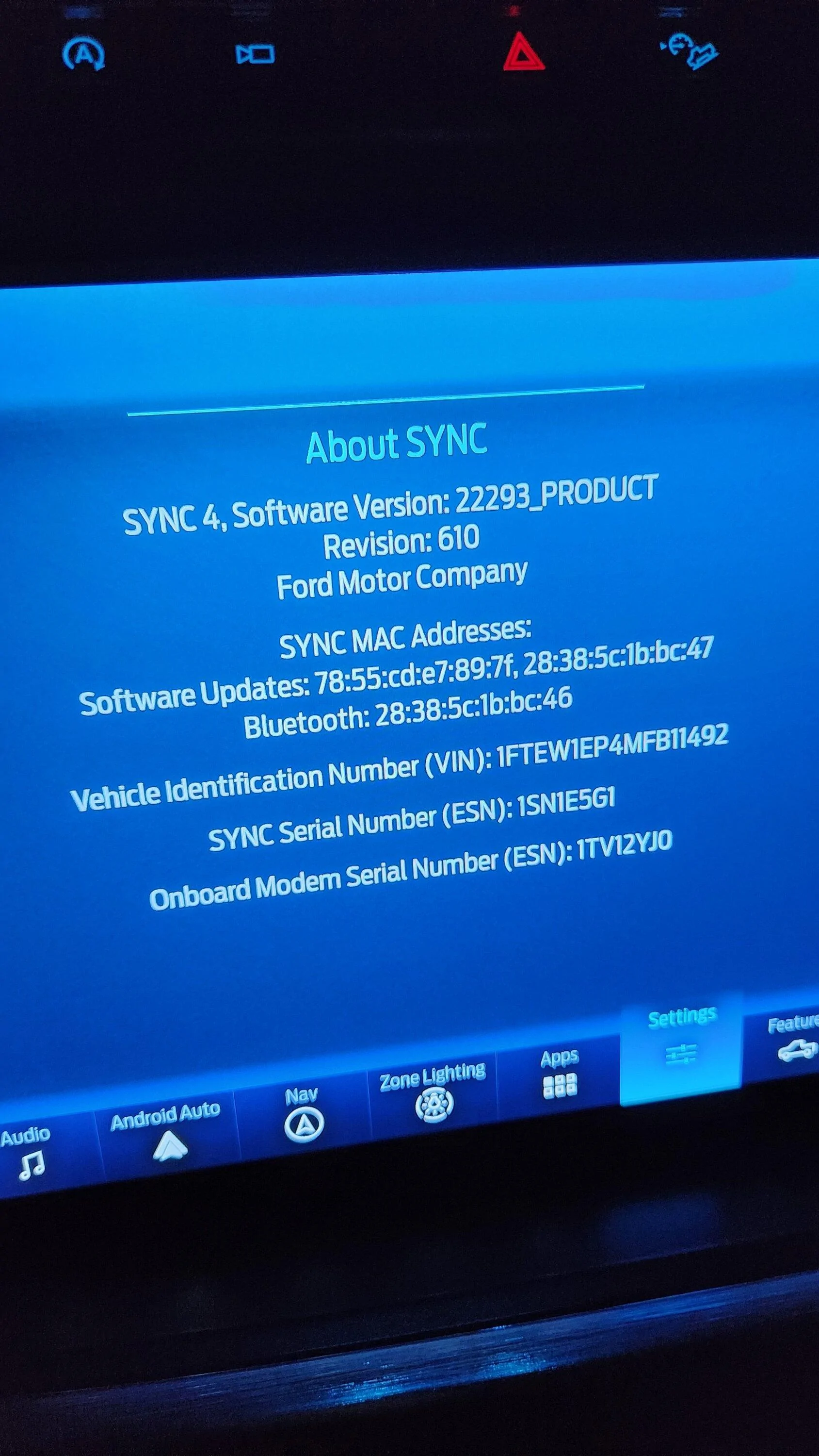

A huge thank you to everybody and especially @Jesse-Infotainment and @rugedraw for your help and guidance with FDRS. The truck is finally fully updated and along with some ForScan mods, it's exactly how I want it to be.
I'll take a few more photos tomorrow with the new sync layout and Android auto is finally full screen.
Well almost full screen, since the right side is used by spotify/calls/etc but at least its controlled by AA and not sync. I'm assuming once coolwalk is activated in Canada, it will turn into proper full screen map :LOL:
