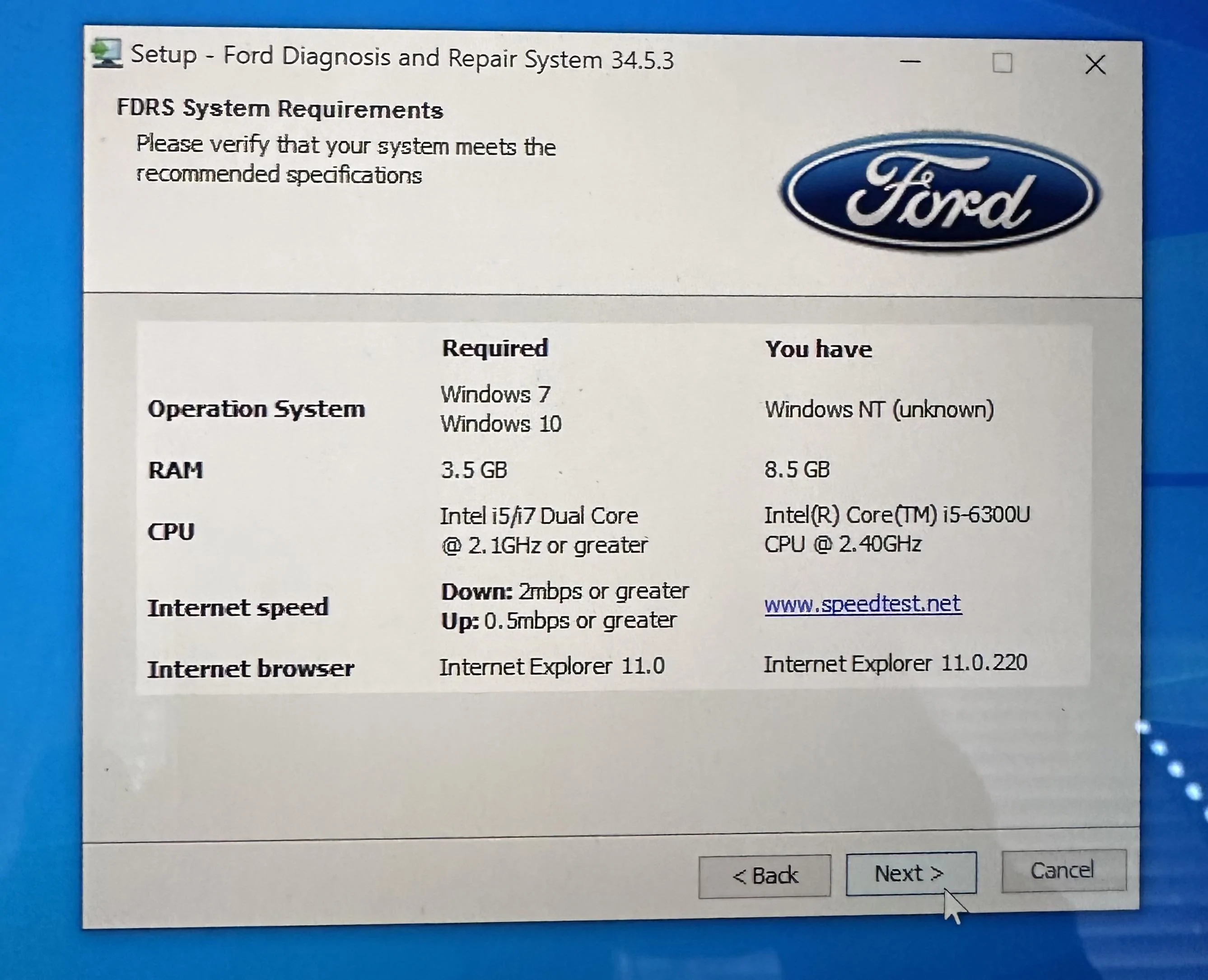

Can I do this using a computer running Windows NT?

I read that Windows 10 and 11 are "required", but what I do not know is if it will work on NT. I am not a Windows user, so I only have access to my work laptop. This laptop is running NT, which I can only guess is a business OS? I am not sure if it is just another version of Windows 10 or 11, just for business use?

Windows NT? Are you sure about that? Windows NT hasn’t been supported by Microsoft in nearly 20 years. It’s older than Windows XP. It’s older than Windows 2000. I seriously doubt it would work. Might be a nice museum piece, though.

When I look at the system settings, it said Windows 10 Pro
but when installing FRDS I see this
Ford F-150 ECU module programming guide using FDRS tempImageXAtVld

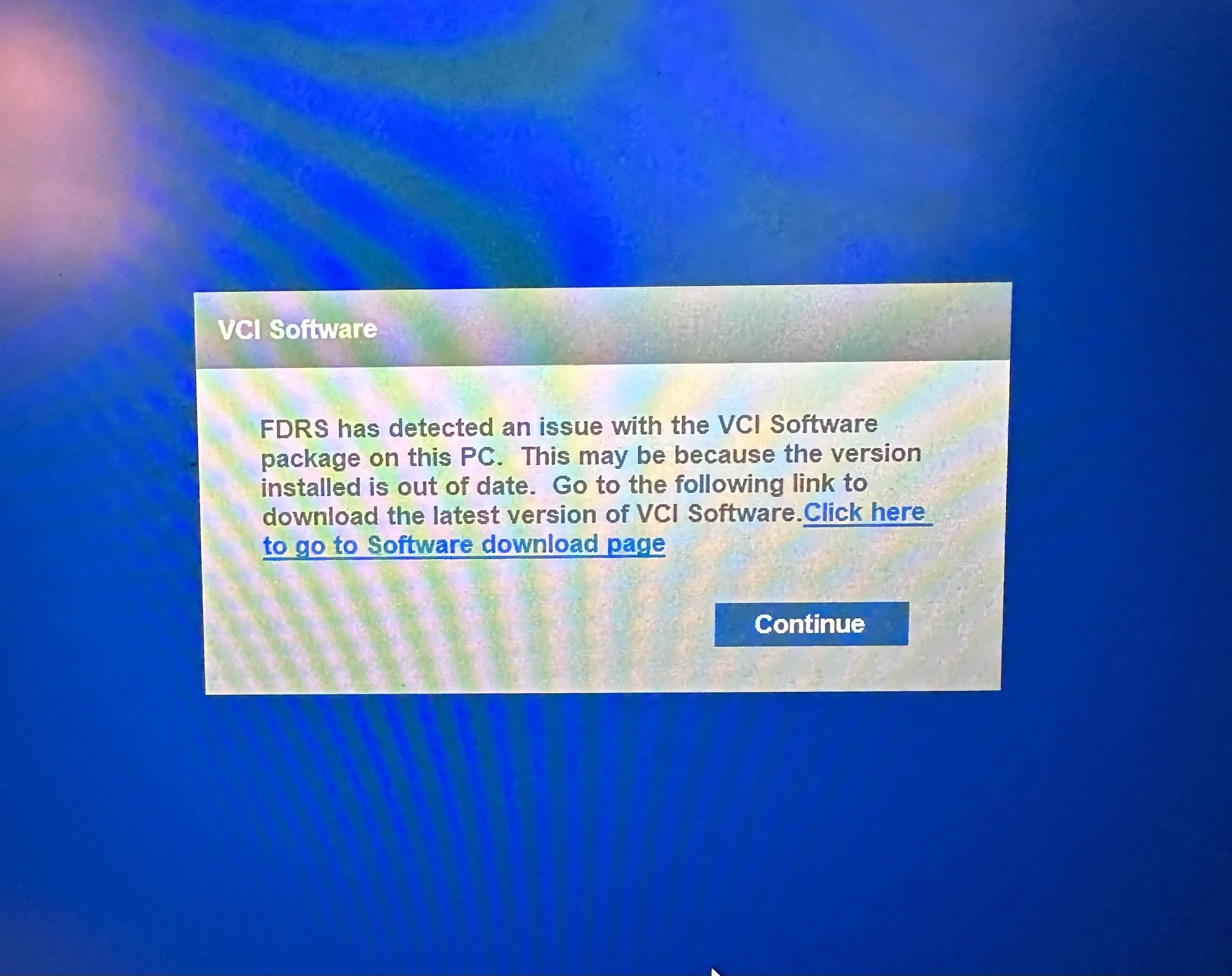

I went ahead and installed it but I keep getting this when I try to run FDRS
Ford F-150 ECU module programming guide using FDRS tempImageXLVa3A
I have installed OPUS IVS and activated my Mongoose, so I don not know what's happening.

When I look at the system settings, it said Windows 10 Pro, but when installing FRDS I see this.
I went ahead and installed it but keep getting this when I try to run FDRS
Ah. The Windows NT reference in FDRS I have seen before. You are NOT running Windows NT. It’s a bug. Don’t worry about it.
The second screen should be fixable by using the link to download and install Ford’s newest VCI software. Another quirk.

First, I appreciate your help very much.

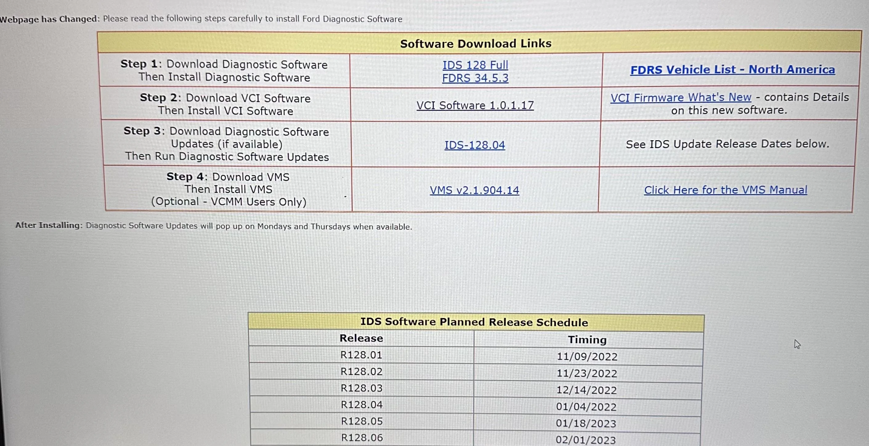

When I click the link about updating the VCI software I get this
Ford F-150 ECU module programming guide using FDRS tempImagexDnNNA
When I click "VCI Software 1.0.1.17" I get this every time
Ford F-150 ECU module programming guide using FDRS tempImageOst5ON

Well, that’s no good. Nothing like doing everything right and getting pimped. Try this link. https://www.motorcraftservice.com/d...ryId=276&from=helm&language=EN-US&country=USA
I can't thank you enough, your magic link worked perfectly. I promise I was following the steps listed in post #1, but to no avail.
I left the Windows world many years ago, and I only fumble my way through it while at work, or when using the many vehicle specific programs that require Windows (like ForScan and the like). I was only taking what I saw (Windows NT) as truth, and I am not aware of the in's and out's of Windows OS versions. I swear it's like learning to walk all over again, haha. Long story short, thank you.
