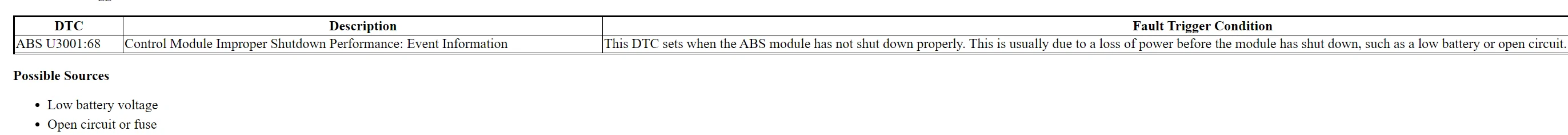

ABS 3001:68
PDM B108F:23
IPMA U2101:00

also for the ABS code I wouldnt worry about it, I would delete the code and see if it comes back.
Thanks, I do have an ABS module update I am doing later in the week with FDRS...maybe that will fix. I did clear the codes and they all came back :sneaky:
