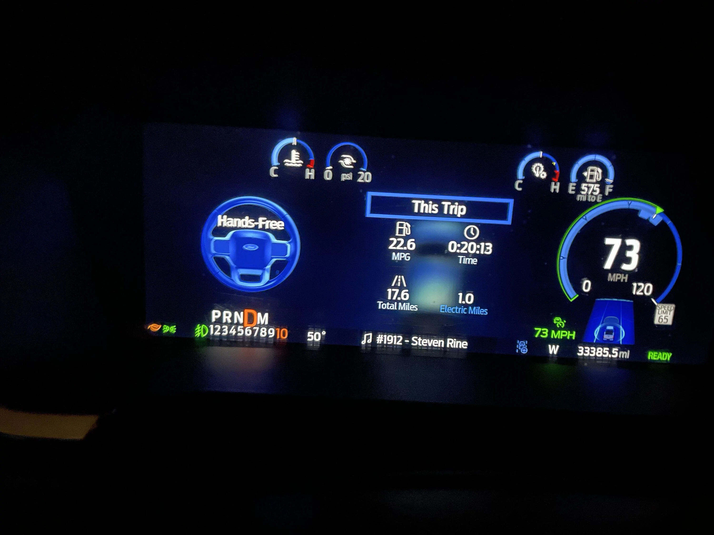

YEah the USB can be hit or miss with the IPC. Im excited for you. Its a good feeling to have it all done after so long
Same to you.. Post a pic of the CLuster when you can when BC is working
Probably not the best time for my first time trying it out since it was raining pretty good this morning. But it worked. Feels like it wants to hug the white hash marks whether they are on the drivers side or passenger side. But hopefully the rain holds out this afternoon so I can get a better feel for it.
