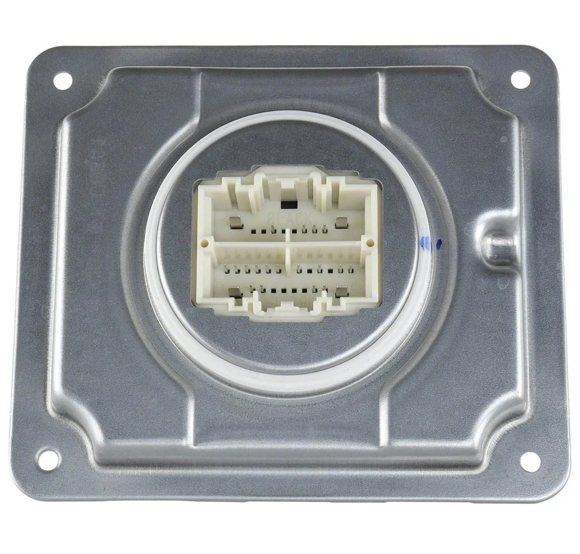

Ya it’s a weird one right side is working fine. Left side white LEDs out but amber hazards and turn signals work.
Leaving the battery disconnected over night didn’t fix it. DTC BCM B14E5 :08-0E
I am wondering if the LED headlight control module took a dump. There is one attached to each headlight.

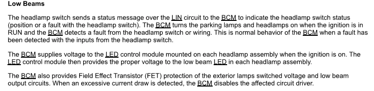

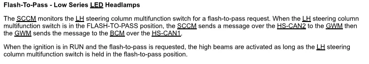

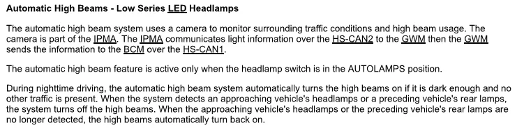

Do you have the original BCM asbuilt saved? One that you would have saved before making any changes? I could compare that to the file you sent yesterday vs comparing the data that is online. Maybe something is being missed. Also, there is some verbage below about how the "Low Series LED" work.

I was going to tell you yesterday that code is related to the left headlight and if it was working right or not, but everyone go you in the right direction. Strangely enough I have a similar code, might be the same one, might be slightly different, at times, but that is because I have my factory DRLs disabled in the BCM, so they throw a code at times for some reason.

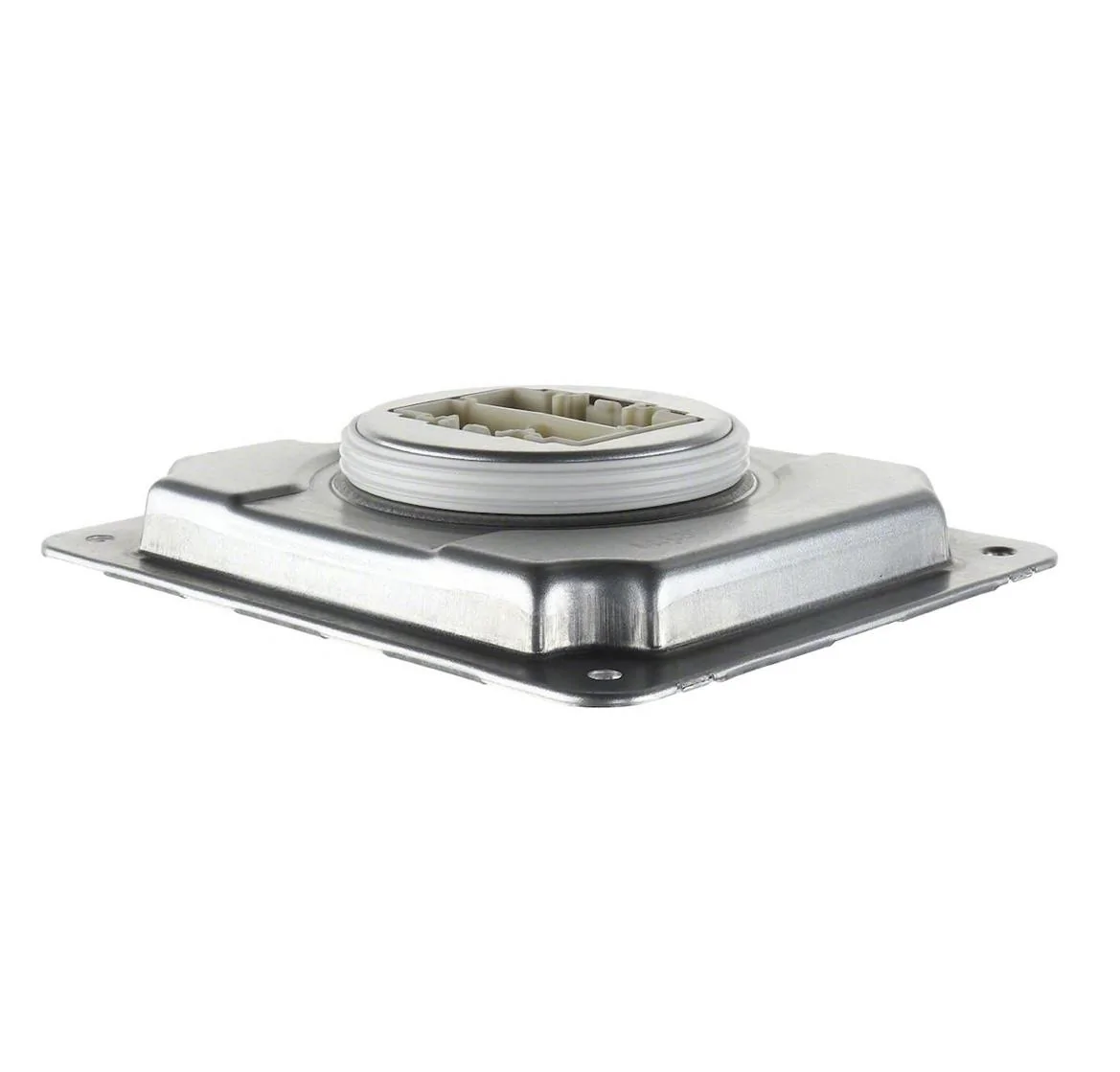

If it is just the module that wouldn't be horrible. You might swap the right one, or the whole headlight just for some swap nostics. If not a new one only looks to be about $140, JX7Z13C788N.

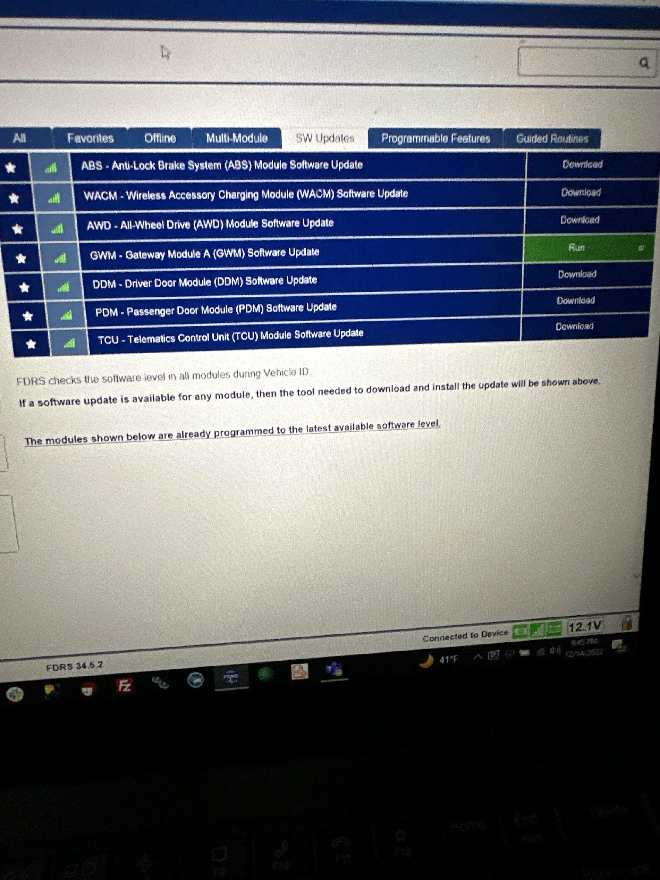

Question for the gurus
@Snakebitten @Jesse-Infotainment
My bronco has an update available for the GWM gateway module A SW update
Jesse mentioned the gateway isn’t open to the 22293 update on my bronco yet- would get me to the new APIM SW for the full screen 22293, by updating ?
