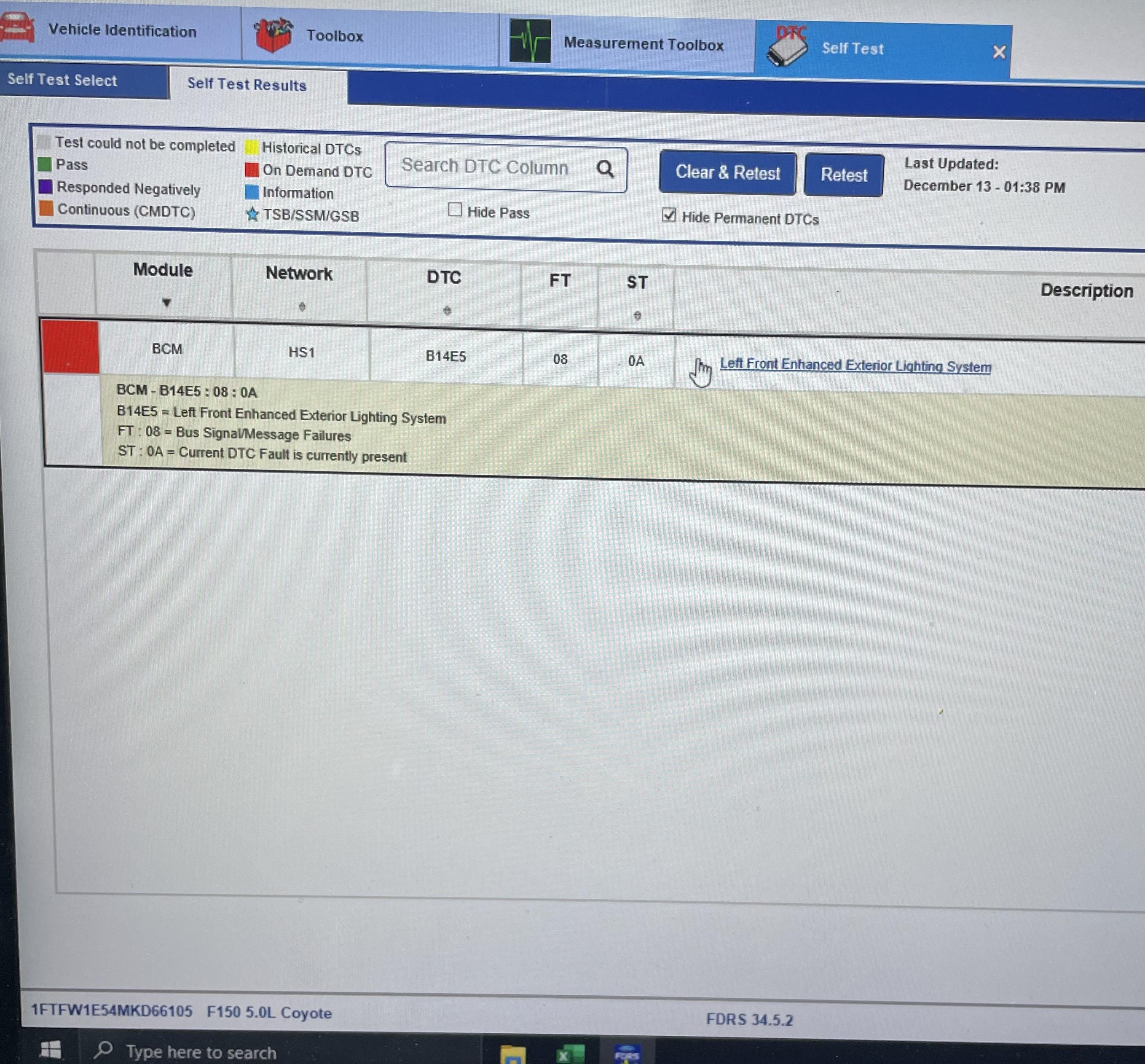

So after the BCM update(s) I got this error. B14E5 :08-0A. Didn’t have this DTC before. Tried to do a clear and retest and it still came back. Everything seems to be working fine. Going to drive the truck a few days and will report back.

So after the BCM update(s) I got this error. Didn’t have this DTC before. Tried to do a clear and retest and it still came back. Everything seems to be working fine. Going to drive the truck a few days and will report back.
That's why I get the chills every time a BCM update shows up. I hope it clears itself soon!

Ah the entire headlight and DRL for the left side is out now. Amber side marker is working though.
