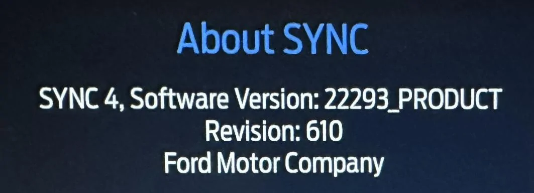

Just so everybody is aware..it's been a couple of weeks for me with the Sync 610 revision...and yesterday afternoon a GWM dropped for me. I'll be doing that later today. Hopefully that will enable something that I'll notice as a change, cause I still haven't figured out what Sync 610 was supposed to bring to the party. ?‍♂

I'm now on rev. ML3T-14H021-LCD on my '22 Lightning but that's literally all I can tell you. Both the previous update of my APIM to Sync 610 and this GWM update have provided zero clues as to what got changed or improved.

Finished updating my Feb build 22 today, started yesterday afternoon and just finally finished up. APIM is now on version 222293. Had 10 modules to update, after the APIM updated a TCU update popped up, so did that update also. I had receive the 3.5.2 power up back in September, but didn't want to wait any long for the latest updates.

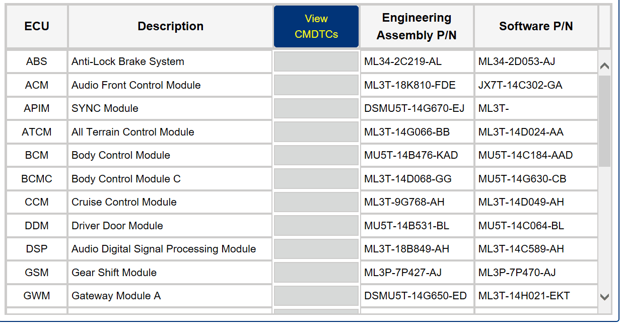

I am currently on power-up 2.7.4 and no OTA updates are available. I took the truck to a dealership and they stated that there are no updates available. I decided to purchase the nano and the FDRS license, i followed all of the instructions and I do not see an update available. My VIN is 1FTEW1EP2MFA81165. This is all I see for my updates:
I did notice that the in the vehicle info tab, the Software P/N for the APIM is missing some information.
Any suggestion first, on how to get get the truck to update to 3.5.4 and second, how to address the APIM info?
Thanks
I spent all of last weekend updating all of the modules listed with exception of the CCM (since I have the nano). No additional updates were available last week before my 2 day FDRS license expired. Would someone be willing to check my VIN, 1FTEW1EP2MFA81165, and see if there are any additional updates available before I spend more on an additional license. TIA.
