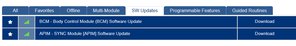

Looks like a new APIM Update just dropped. I’m downloading it now. Came up after I ran a scan in the truck.
yes 22293
seems to have released today.
It was released for 2022 MY a few weeks ago
So Ford is keeping the 2 model years unified afterall, but with a lag?
Still odd that they release new APIM updates before they OTA the previous one. It's not like dealerships are installing 22228.
You KNOW they aren't releasing the latest just for those owners using FDRS. Yet they are the ONLY trucks that will get it.
it’s about 3GB
any idea whats in the update ?
