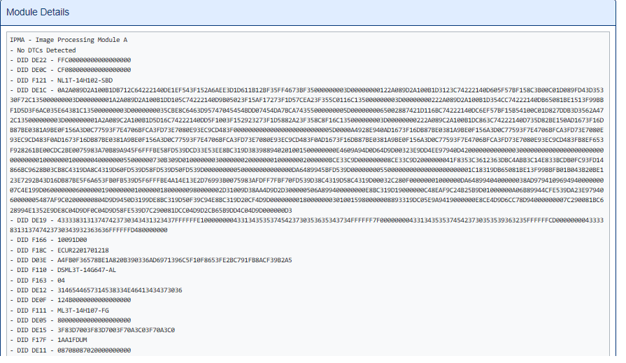

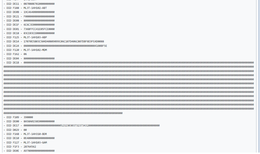

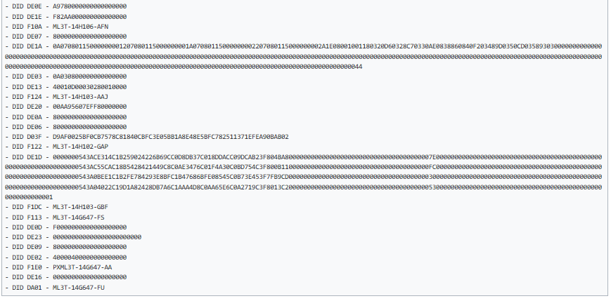

This is usually an indication that a file failed to load and now FDRS doesn’t recognize the state of your system. Can you post the part numbers that show up when you highlight the IPMA?
I'm not entirely certain what you're looking for but here's some info
Ford F-150 ECU module programming guide using FDRS 1666533473677
Ford F-150 ECU module programming guide using FDRS 1666533505624
Ford F-150 ECU module programming guide using FDRS 1666533529348
Ford F-150 ECU module programming guide using FDRS 1666533553657
