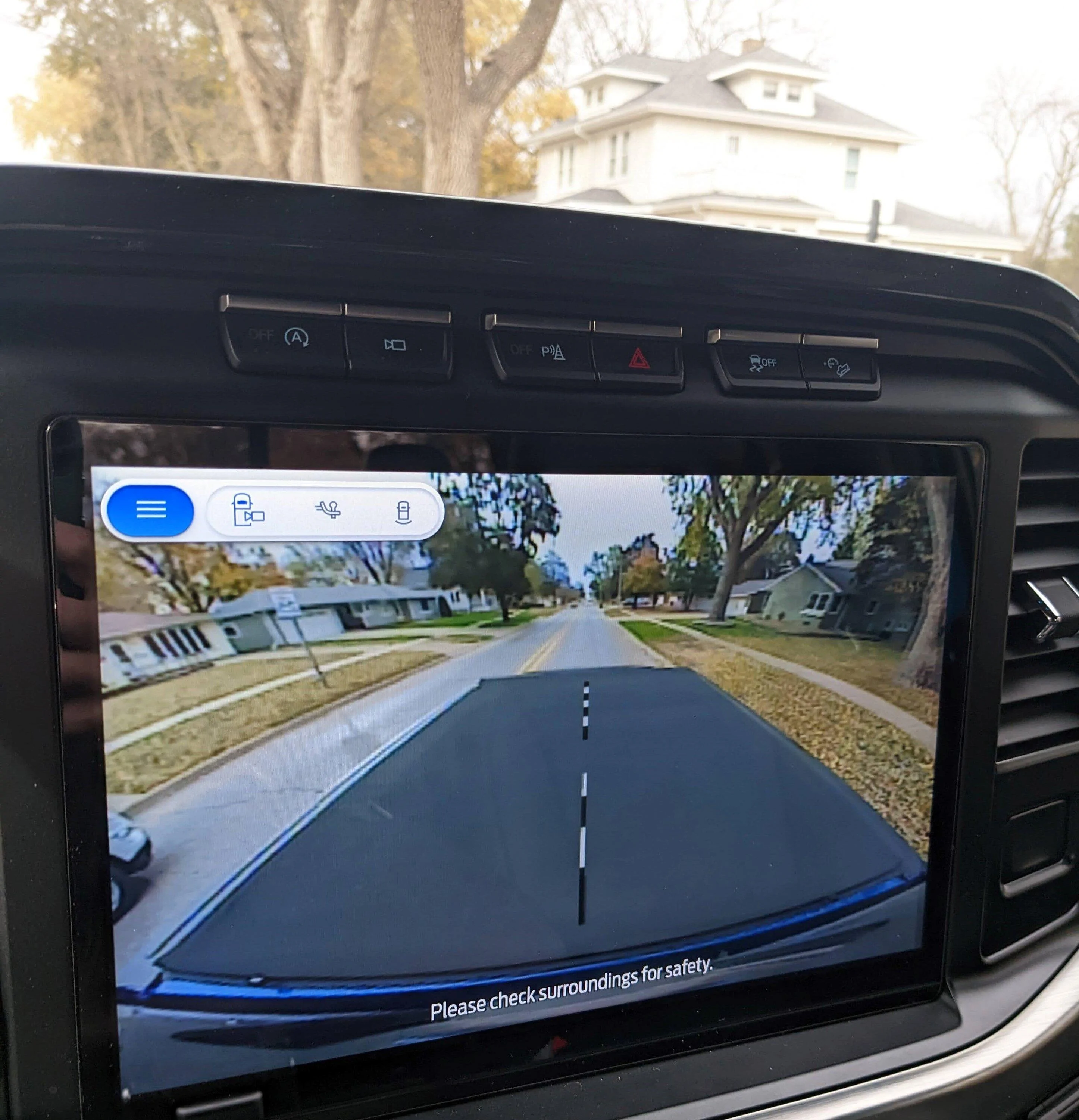

@Jesse-Infotainment I made all the changes you suggested. I now can view the Bed and hitch camera's at speed and switch between the two. If I switch to the rear camera the ability to switch goes away and have to wait until I am stopped to switch away. I have reset the APIM and IMPA multiple times after making the changes also. Any ideas?
No. Not off top of my head. Send me pics of the ipma config in forscan. Top few lines
Send me the apim also and I’ll take a look
Also include your vin
