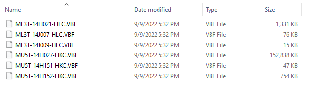

So I should start at the top of the list and work my way down or do some in order?
I'd probably start with the PCM and then work my way down. That actually seems to be in the order I'd likely do them. I like leaving USB updates for last.
Have fun!
Thanks Mike...my first go at it and I have all weekend.
