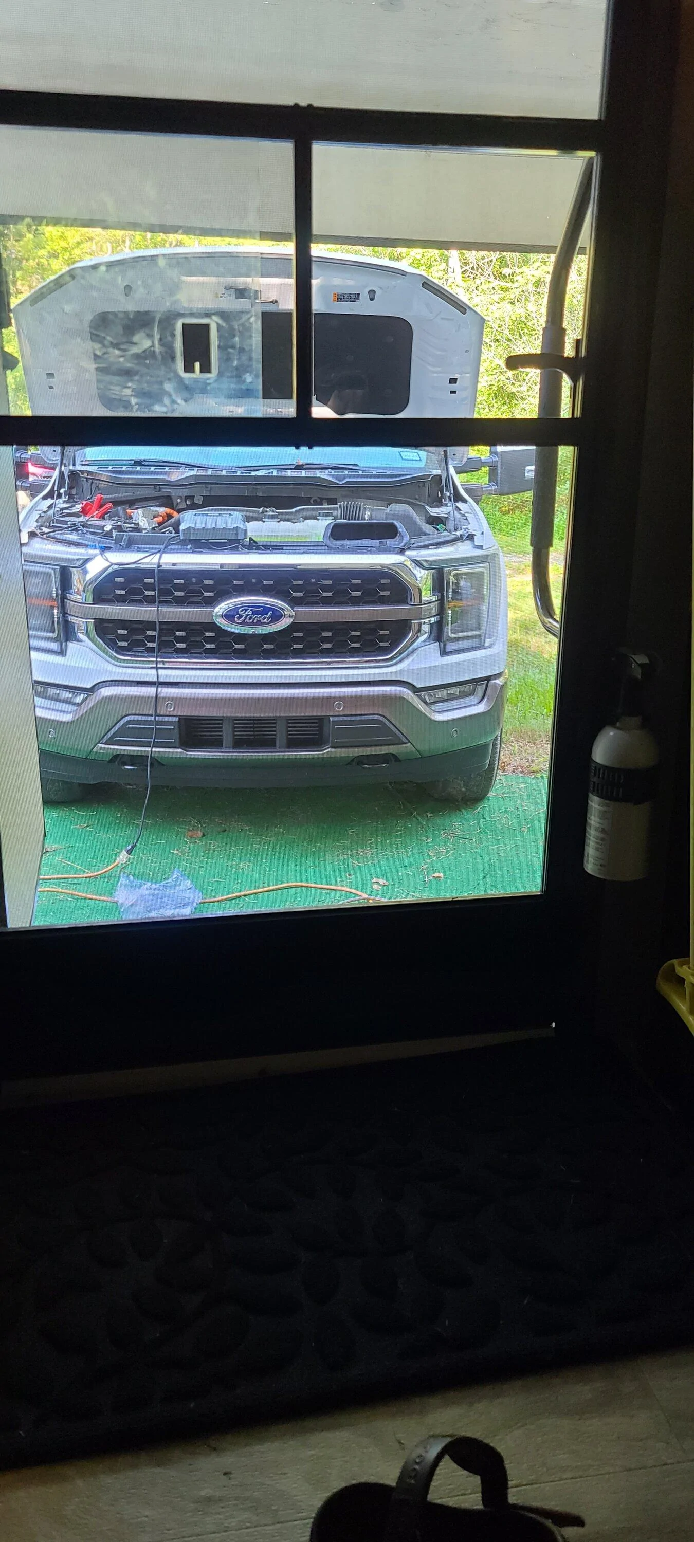

Anyways, yes yesterday a GWM update popped up in FDRS for my Job2 2022. It was the FIRST meaningful update offered for such a recent build. I jumped on it rather than waiting for OTA. ?
Truck spent the night on the porch of the RV. I even gave it a good healthy trickle charge as desert for being such a good truck so far.
Ford F-150 ECU module programming guide using FDRS 20220910_093041
