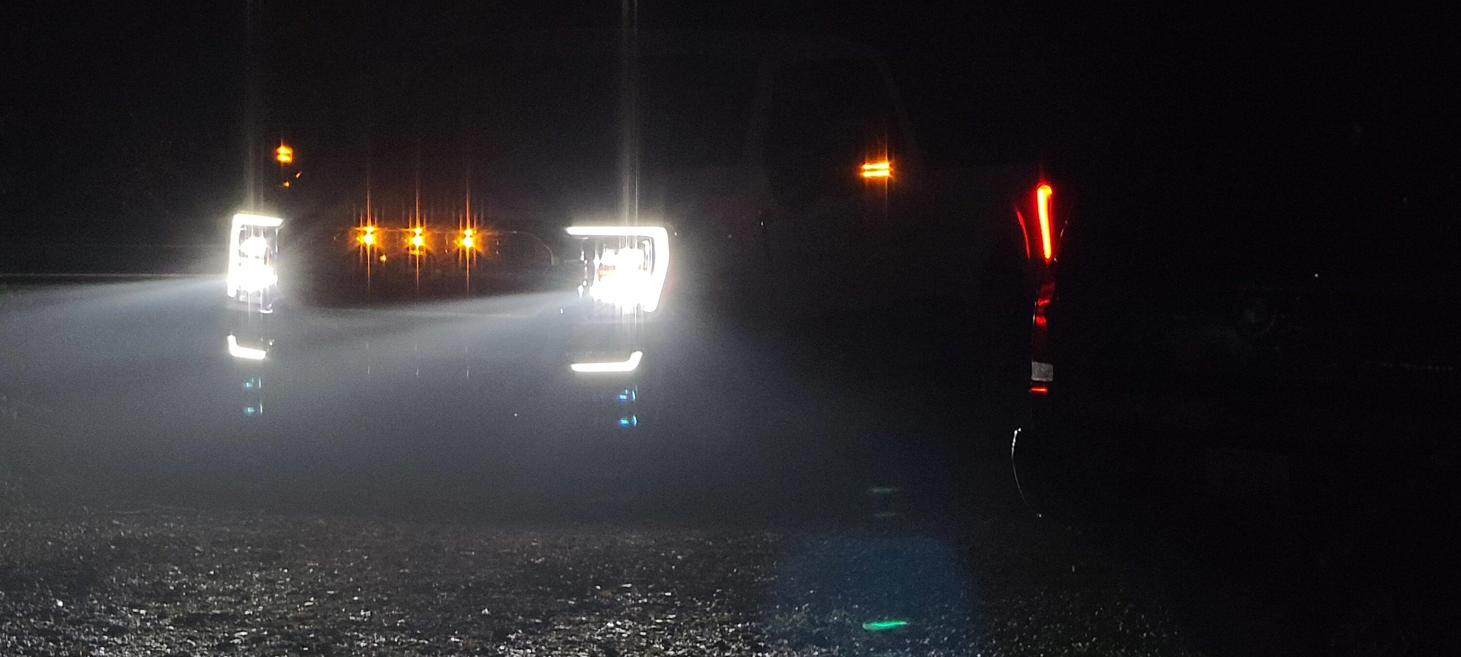

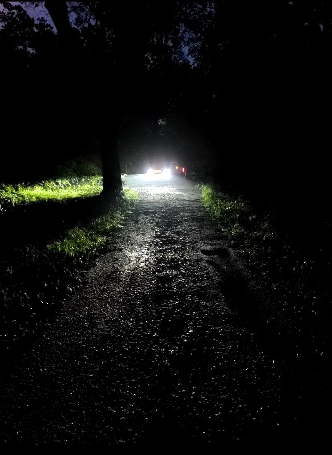

Strangest thing happened a few minutes ago. I was walking back to the RV from the chicken coop and the truck lit up like a Christmas Tree.
There's nobody in that truck. It's parked. Has been for a few hours.
Ford F-150 ECU module programming guide using FDRS Screenshot_20220908_202058
Ford F-150 ECU module programming guide using FDRS 20220908_200349
It wasn't running and accessory power was not on and the FOB wasn't nearby. I grabbed the FOB from the RV and remote locked it. Nothing changed. Unlocked it. Nothing changed. ?

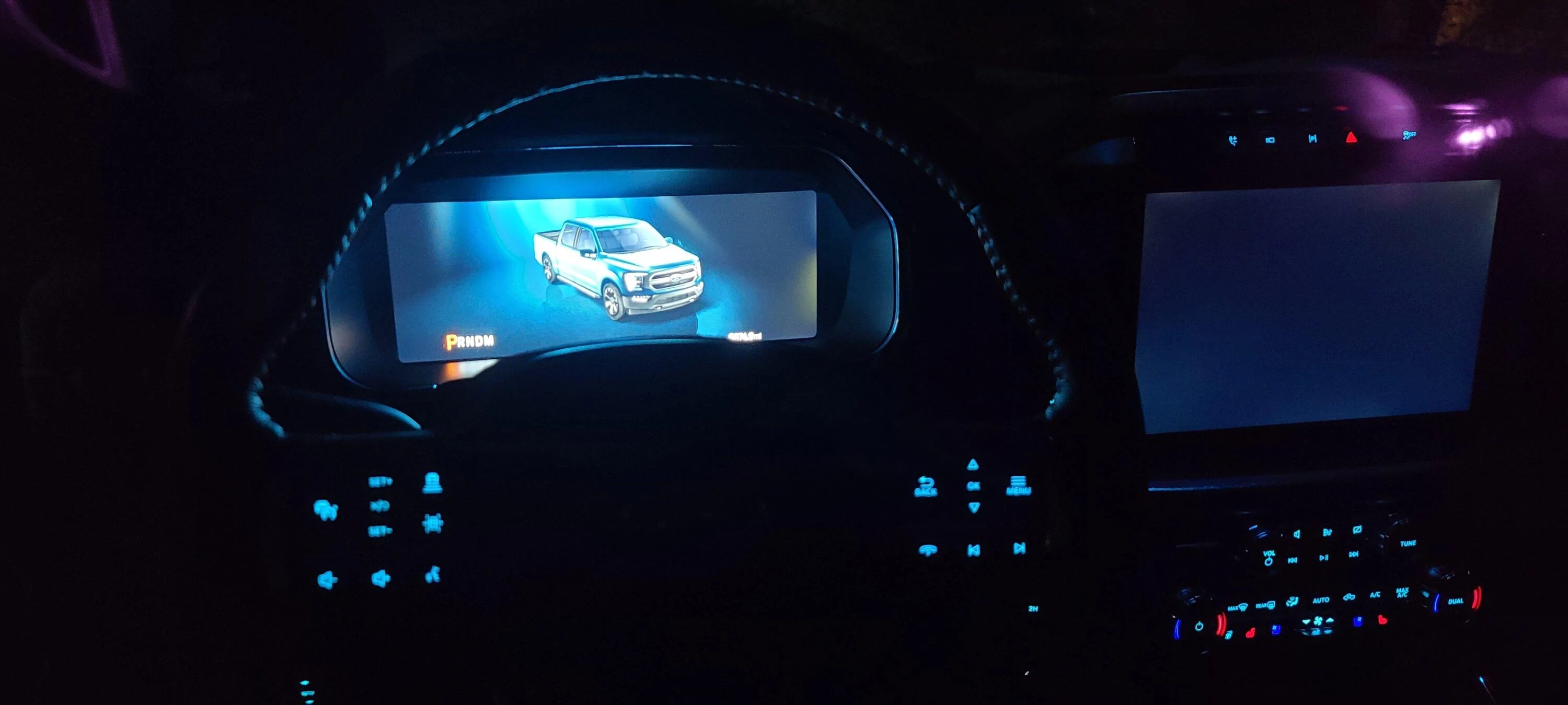

I got in and the Sync screen had a feint back light and the IPC had the sliding blue F150.
Ford F-150 ECU module programming guide using FDRS 20220908_200546
I turned accessory power on and the headlights immediately switched to parking lights only. (they are on Auto)
Turned the truck off and it shut down normally.
Never seen or read anything like it. It would make sense if it was receiving an OTA?
It's exactly what the truck does with FDRS plugged into the ODB and accessory power on.
Wonder if I hadn't intervened if it would have ever shut back down?
