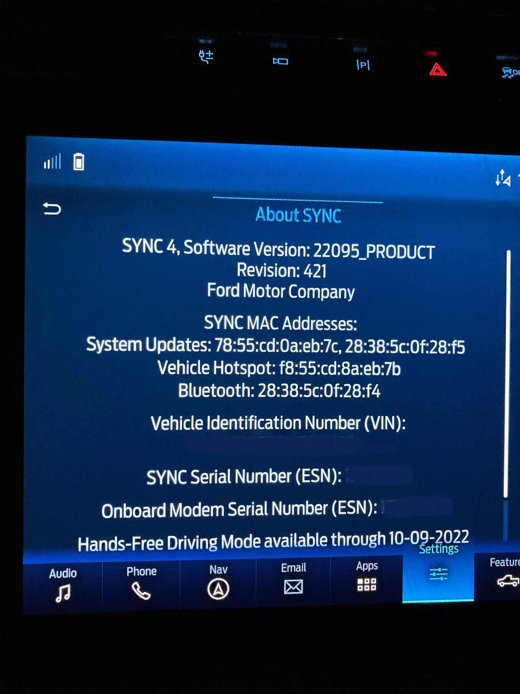

I was concerned about doing the updates myself and I also objected to having to pay for the FDRS subscription for a new vehicle with less than 2,000 miles on the odometer. Of course, my wife told me several times, “The truck is working right now. If you mess it up, you will be towing it to the scrap yard and I won’t give you a ride home!” I bought all the recommended equipment but remained hesitant.
Two dealers tried to do updates without success but one agreed to try again. I took the truck in Tuesday morning and they had it hooked up all day and then left it on overnight, finishing early afternoon on Wednesday. The two photos show my Sync screen before and after. It appears that numerous updates were installed and Blue Cruise is now activated. I am thrilled with this progress.
I want to thank @Jesse-Infotainment, @iceman77, and ALL who posted in this thread-I read every one of them, multiple times. Your experiences helped me reach a better understanding of this process. Even though I wasn’t brave enough to ignore my wife’s warning and try it myself, I was able to talk to the dealership personnel in a more coherent way.

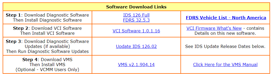

Good afternoon everyone, I posted a question on here a little while ago and was informed to only download the 1st step (FDRS). I had downloaded the FDRS 32.5.3 only (step 1, and not IDRS 126) and tried to open it, but I kept getting a message advising I needed the VCI software.
I went ahead and downloaded the Step 2 (VCI software). I can now open the software. My question is do I need to install steps 3 and 4? I am only using FDRS to update my trucks software. Do I need the IDS software? Thank you, I attached a screen shot of the steps.
That was my mistake. Sorry. I didn’t realize you needed the VCI manager when you are going to use a J2534 device. Did you try installing the Mongoose drivers before opening FDRS To make sure you actually needed the VCI software?
I know you don’t need steps 3 and 4. Step 3 is to update IDS. You aren’t going to use IDS. As for Step 4, I’m pretty sure that’s only for VCMM devices, which you aren’t using.
Thank you for the replay and that is okay. Yes sir, I downloaded the Mongoose software first and then FDRS.

IDS is for only early build of Fords. The 21 F150 is FDRS only. Fdrs is also for ALL sync programming now. That means all including Sync 3 and MyFord Touch and others.
IDS requires a license that I am not sure how it works when you buy the license you guys do. I buy a year license and get an long activation code. So I am not sure that is the same for two day license.
