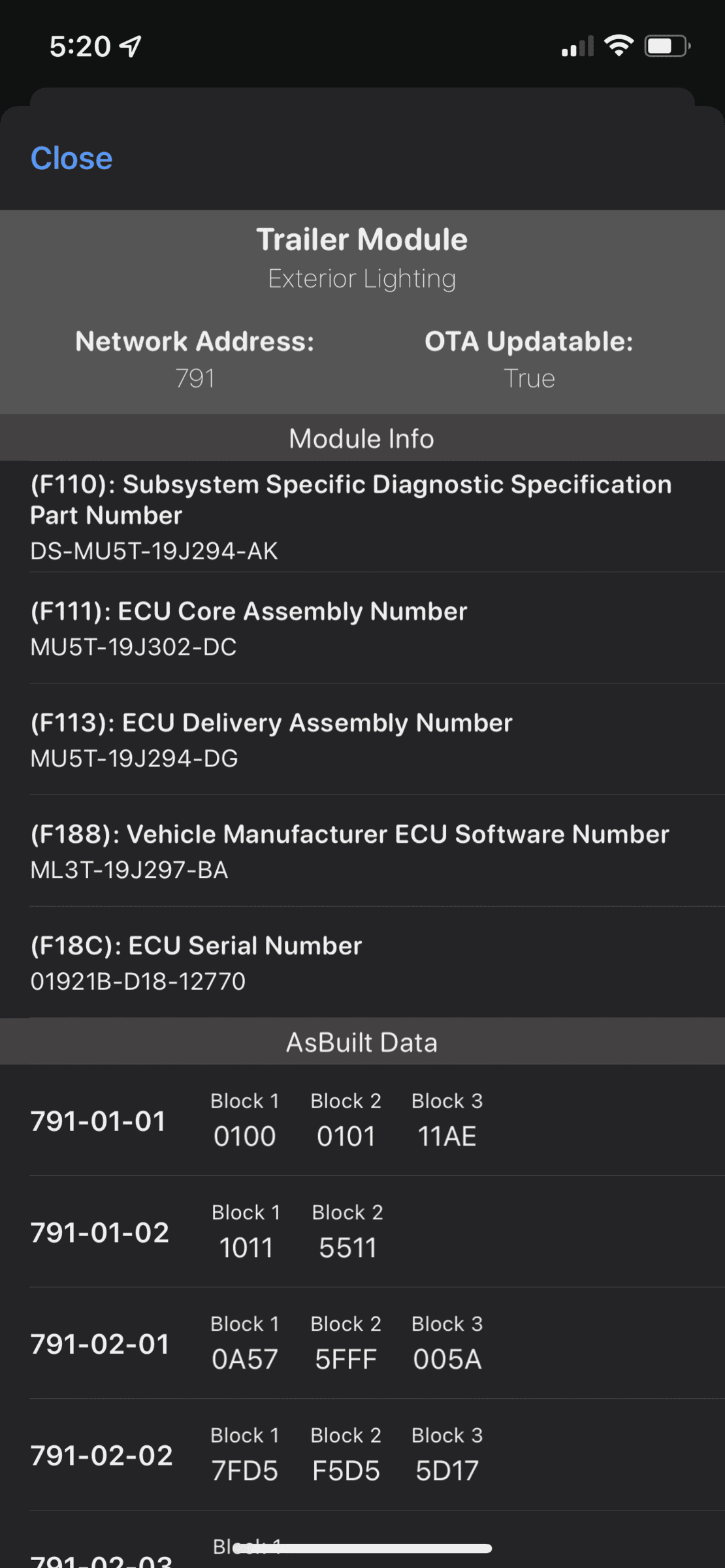

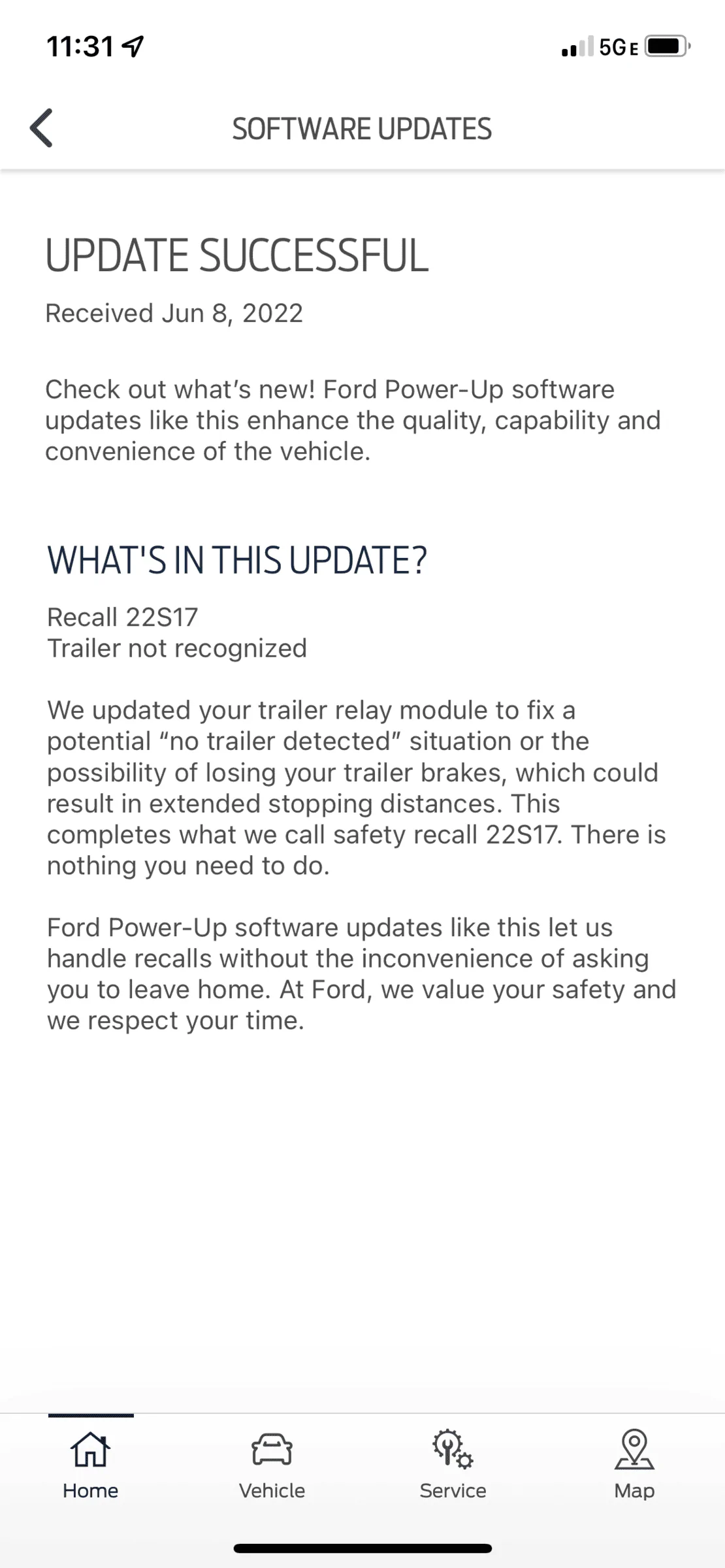

First OTA update I got since doing all the FDRS options myself. I purposely didn’t upgrade the TRM manually cause I wanted to make sure the recall gets cleared from the VIN… glad to know OTA… is somewhat working for recall options.
Check to make sure you got the latest version. One person asked me to check for him and he did not. He got -BA OTA.

My Job 1 2021 F150 Powerboost received the PowerUp update overnight for the TRM. I logged into the Motorcraftservice.com site, plugged in my VIN and looked at the OTA status. It now shows the version now as *-BB for the TRM. This is the second PowerUp update my truck received since purchasing in Feb 2021. I did recently upgrade all modules using FDRS to enable BC. I don't use BC much, but I am still enjoying the much improved transmission shift / EV characteristics.
OK so quick note. You need to wait awhile after the truck updates to get the correct software version. After mine updated the TRM OTA… I went and downloaded the latest data, it showed -BA under the F188. After I waited about 6 hours I check again and now its showing -BB. So I would give it time to upload to the mothership.
right after the OTM TRM update…

About 6 hours after the TRM OTA update…

Also FDRS shows the BB version and it already removed the TRM update out of the SW Updates tab automatically. No longer an option to update it manually.
Yeah. I am aware that there’s a lag, but the one I looked at this afternoon was supposedly updated OTA overnight and the as-built on Motorcraft still shows -BA as of 8pm CDT. That’s a pretty long lag. Hopefully it’s just an unusually long lag and will eventually update.
