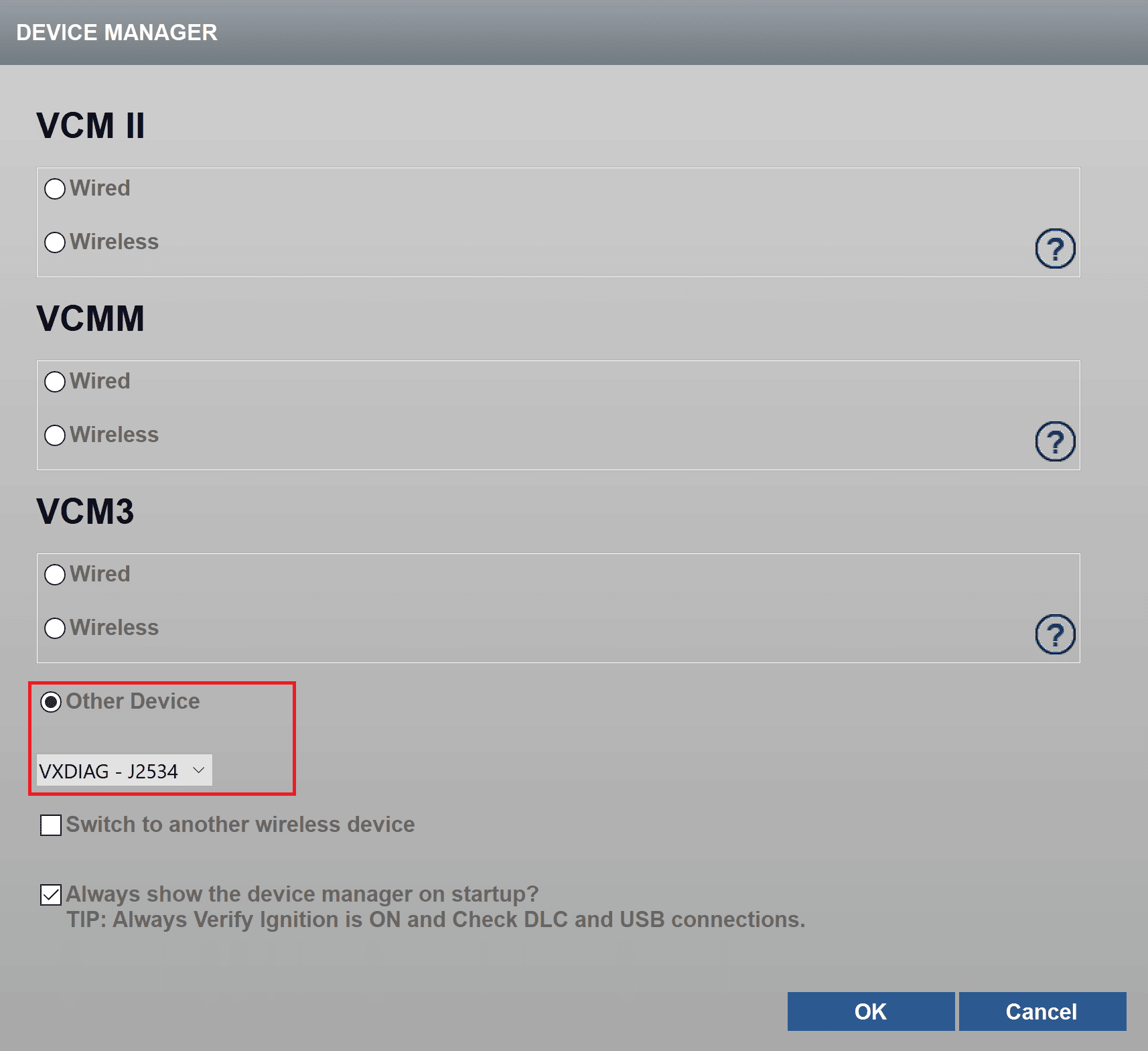

Any idea why this radio button would be missing from FRDS version 32.5.3
Install or reinstall the driver for the J2534 device you intend to use. My Mongoose is showing up in the manager normally.
