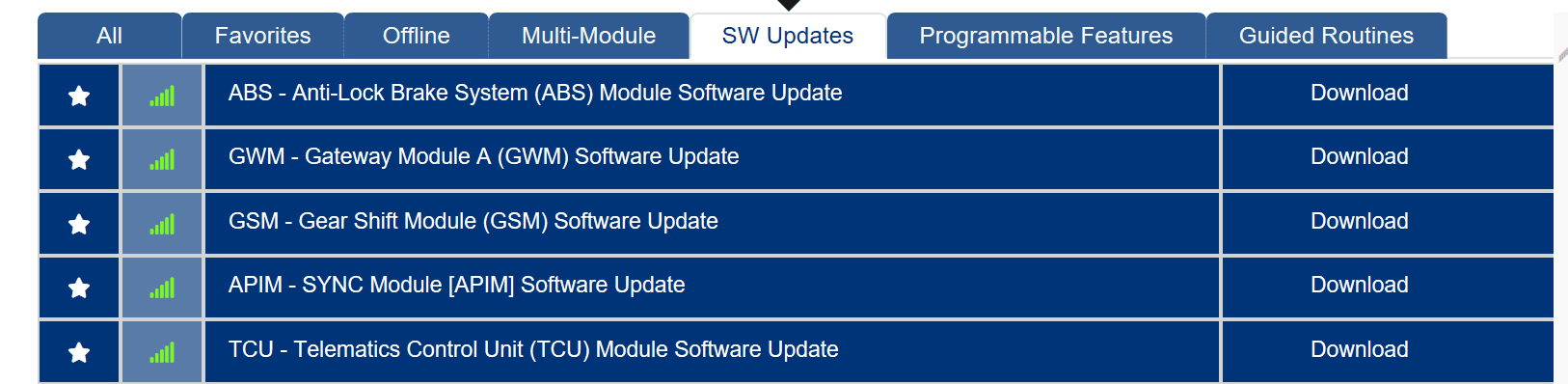

APIM is 864MB for this update.
Both TCU and APIM updates are KonEon and need to see a full shutdown as usual.
APIM gets updated to 22087, rev 415
After successfully updating TCU and APIM a GWM will become available as well.
GWM is at least 248MB for this update but will confirm after it completes.
GWM Is KonEon and need to see a full shutdown as usual.

My APIM download is 2.1Gb so I'm really curious what's changed.

I’m doing the APIM now as well and can confirm the TCU and APIM want to be ran together… job1 302a XLT 5.0L

And new GWM is now available after APIM and TCU are ran as posted earlier.
