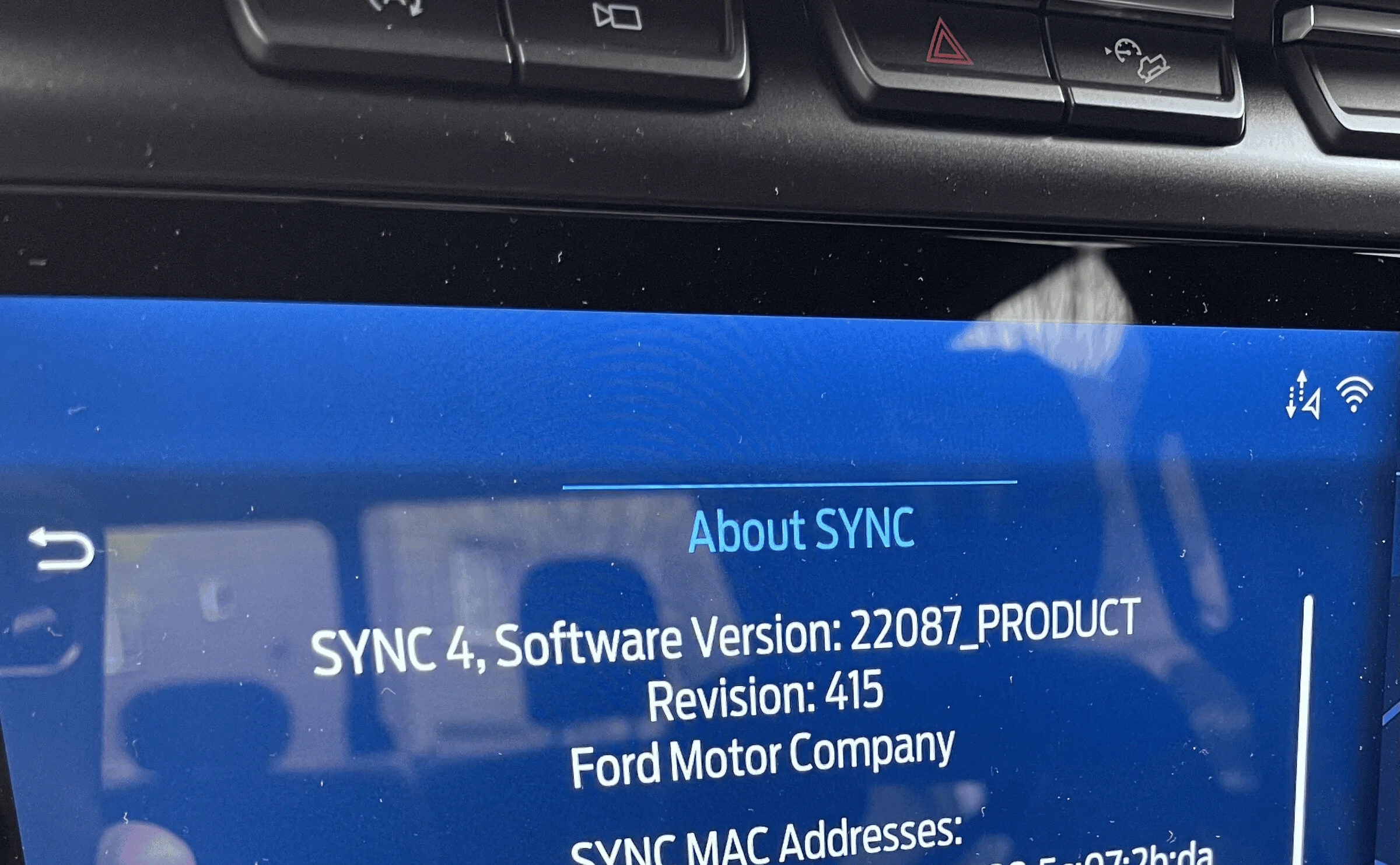

About 2 hours into updating and everything going smoothly!
I can say everything still going great, some USB mostly others done. Now just gotta keep plugging. The waiting on the restart was definitely the most nervous I got.

I’m doing the APIM now as well and can confirm the TCU and APIM want to be ran together… job1 302a XLT 5.0L
So just to confirm, you were finally able to update to a newer version than 244? 8" cluster, no 360, no BC? If so, I know what I'll be doing tomorrow!
Yup! I did the TCU first which will combine the APIM. After those complete my sync showed 22087 rev415. Once those completed a new GWM update will also be available.

Yup! I did the TCU first which will combine the APIM. After those complete my sync showed 22087 rev415. Once those completed a new GWM update will be available.
Notice any changes at all? Alexa?

No Alexa that I can see. I honestly don’t notice anything different since I updated.
How long did these updates take? If they're pretty quick, I'll buy my 2 day license and knock them out tonight!
Lariat 502a took about 2 hours no BC
