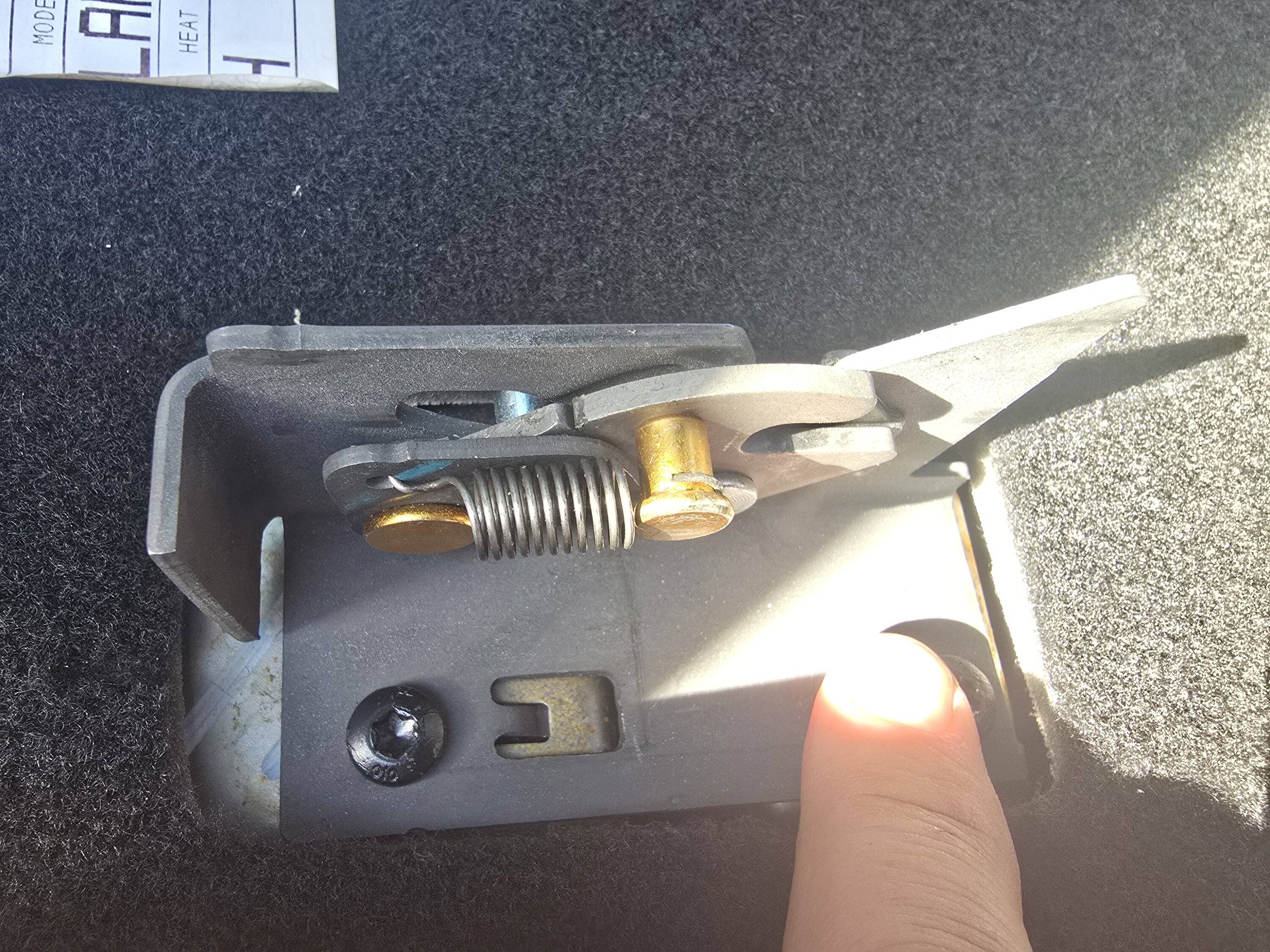

I know this isn't a mod but don't know where else to post. I got a 2021 lariat and almost hit a deer and in hard braking my rear seat flopped forward. I discovered the rear seat won't latch. The latch on the seat itself functions if you push on it with your finger but there is a plastic piece in there that would keep the striker from pushing the mechanism. Also the striker just freely moves up and down on the cab can any of you explain to me what the heck I'm missing?

This little pin here has to move up before it can lock into place. It also is what releases the latch.
There are a few posts including one of my own where you drill a hole in that PIN secure a tiny ring and then an additional zip tie and secure it to one of the posts of the headrest. You can pull that thing up with ease and get into that back seat area with no problem after doing this. It only takes about 5 to 10 minutes to complete the entire ordeal. I have no idea why Ford didn't include an easy release in all of the trucks. It would save all of us a headache.

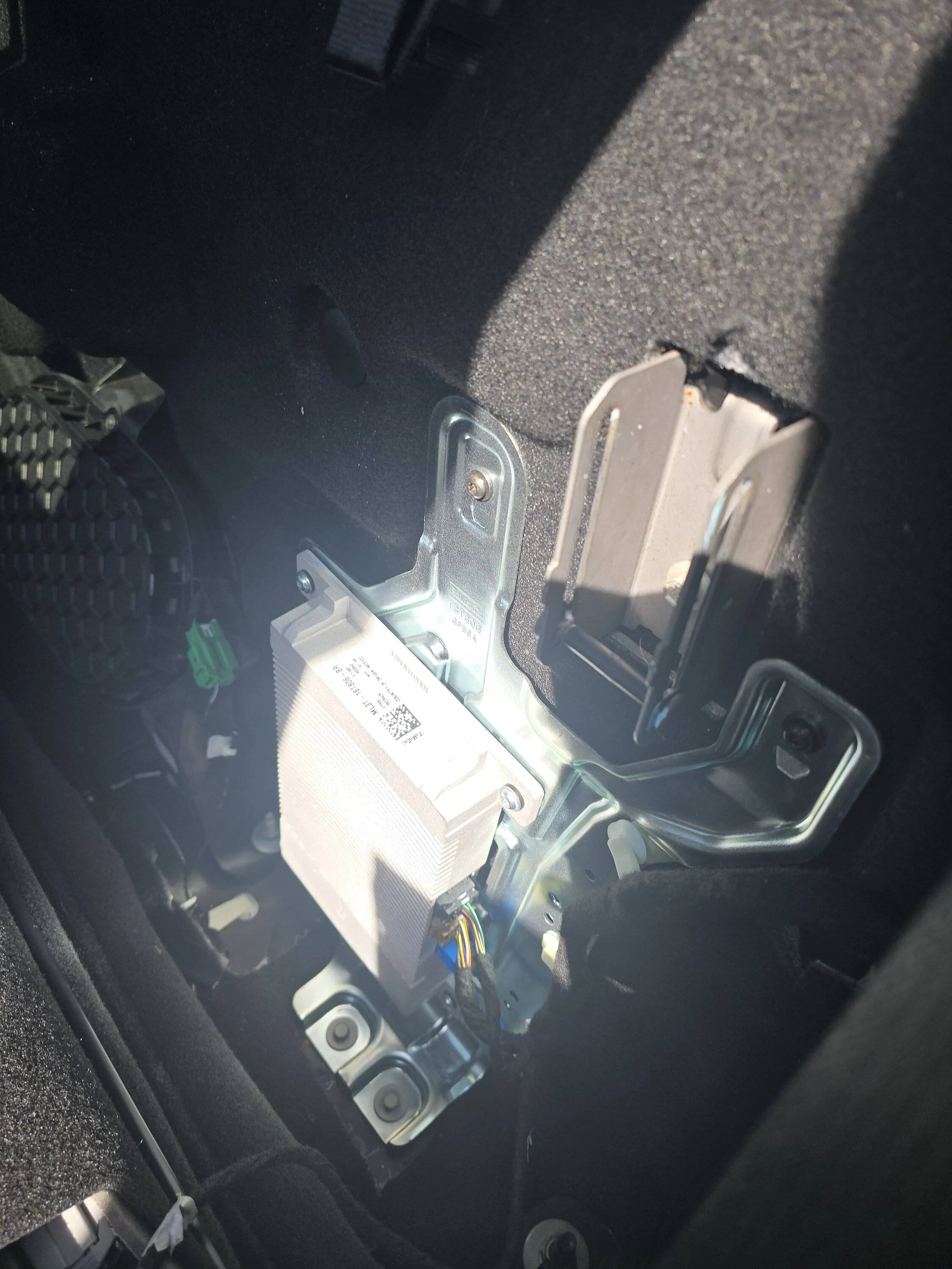

The striker is designed to move up and down, it allows for movement when you flip the seat cushion up. Typically I line the striker up with the bumps first (circled in the photo) before trying to latch the seat. And some you really have to give the backrest a good shove to get them to latch. Don’t try to softly latch it.

I've moved the pin on the side and can get the clasp to latch but it's not like spring loaded or anything it seems... I can try slamming it but how do I ensure that it's lined up with the striker before doing so

I elbow mine closed. Use the alignment indicators to set the sliding bar. As you lift the seat bottom, the rear begins to rise and come forward slightly and that's when your hand can fit back there.

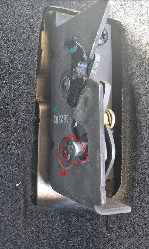

How did you get the seat back down to install this?
fold the seat bottom up and reach behind and pull this little tab up to release it. This image is upside down
Ford F-150 Driver's rear seat latch 1742070108114-88
Everytime I get behind the seat I just use this method. The unlock strap is probably easier, but the factory method isn't difficult.

I forgot to report back that I was able to get it to latch by lifting the bottom and slamming the back thanks for the input guys
I was about to order one, but read today that if you have the B&O sound system it doesn't work (latch) correctly. Is this true?

21 KR with the 18 speaker B&O sound , and I installed a BUILTRIGHT seat release without any problem. But , as mentioned , you might need to give the seat a good push to get it to latch, once latched it’s solid and it also releases easily.

Gotta make sure it's perfectly lined up and in the open position, then slam it hard like it owes you money
My pic above is in my 24 Lariat with the B&O and it works perfectly. The key is you have to close the top of the seat the way you took it down. If the lower is up you have to close the top portion in the up position due to the sliding latch.
