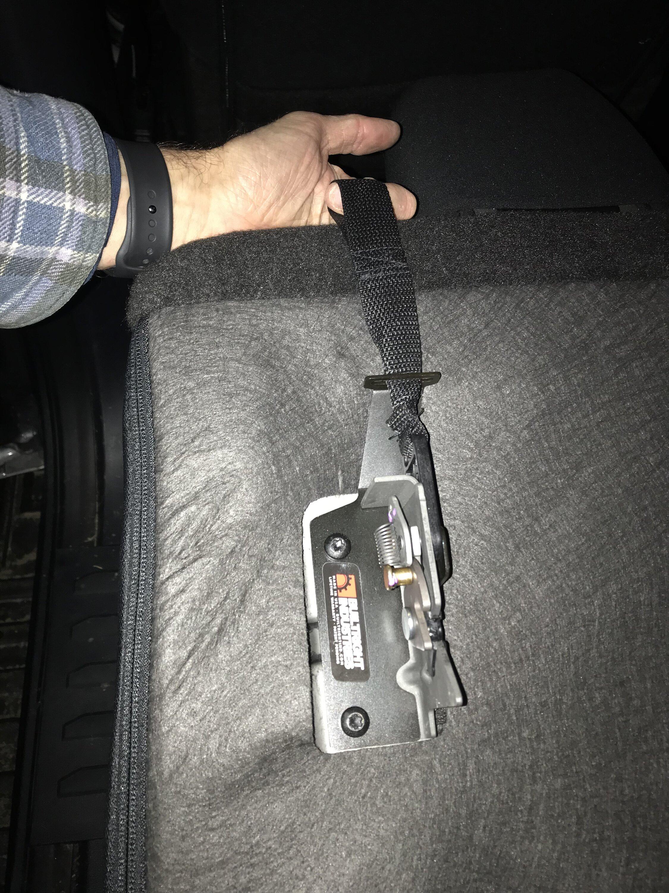

Super easy mod and one I was looking forward to. Easy to order and deliver to Canada. If I didn’t stop to take pictures, would have probably taken 5 minutes to install.
As others have said, re-latching was a bear. I almost blamed Buiktright but obviously their device doesn’t affect anything, it’s just a weird design from Ford. I think lifting the bottom seat up about 4-6” then pushing the upper seat back hard might be the secret handshake required, we’ll see.
Overall pleased so far - without the Jack like on the passenger side, it feels like a LOT of room.

How easy it is to fold/unfold the seat back in place after the installation? I had ordered one (ordered on Amazon) and installed and it was way to difficult to close it back. Note: On Amazon it was showing the builtright logo but the one I received was a freaken copy.....

What I’m finding is lift the seat bottom a couple inches then slam the sheet back. Lift too much or not at all: doesn’t “catch”.
I think it’s just how the latch mechanism is, not an issue with the strap piece. But it may not hurt to confirm the strap “glides” easily or add some grease to its surface so you confirm the strap piece isn’t adding any resistance.

There is a good youtube vid that shows the process you need to go through to get everything realigned after you put this on. It is tougher than it should be, but the vid looks good. The key is getting everything (pins and latches) back to start.

I installed it today.... did require a tiny bit of bending per their youtube video.
Lesson learned... if you fold the seat bench up, it is easier to reach behind the seatback. After using the wrench to unlatch the seatback, don't forget to pull up the strap to unlock the seat bench. I spent 5 minutes messing with the seat latch when it was the locking seat that was the problem. :geek:
