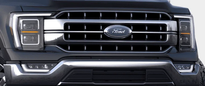

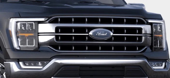

Do we know for sure if the BCM update is safe for platinum with projector lights or should I stay away.

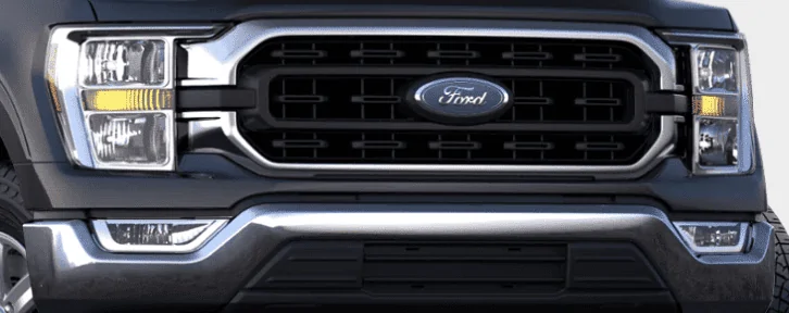

lll I can do is give real life experience. i cant guarantee. The three updates that were done all had the Active DSS headlamps. We all three did not have an issue. The issue originated from @TJSparky when he stated he had a Headlamp out after with a DTC. He ahs the Quad LED headlamp non active.
It was hard to make a correlation after that update. It did get my interest for sure. We worked through a lot of things. Then anotehr guy did the update and had the same exact issue. Thats when I made this post. Then @JDPEagle also had the exact same issue. JDP and The second person both are fixed but required hardware.
The only differences I see between the two is the active doesnt have a linbus at the BCM. So Its possible a bad config signal is being sent out during the linbus config.
I am only adding all of this to give context to the issue
If you have the Active DSS headlamps I have not seen an issue but it doenst mean there wont be.
So it may be best to wait for now.

Out of curiosity, if you have the Active DSS headlamps, is that called out on your window sticker? Are they standard, on say KR and above? Wanted to make sure I was clear on the lamps I have.
My Truck is an XL. Everything My truck has I added.
The Active from Ford are only available 502a and up. Tremor and Raptor Im not sure the package number

Gotcha, I've got a preowned 21 PB Plat, but nowhere on the sticker is Active DSS called out, so I was kinda worried. Either way, think I'll hold off on the BCM update until the dust settles...unless there's an urgent update on this module?
