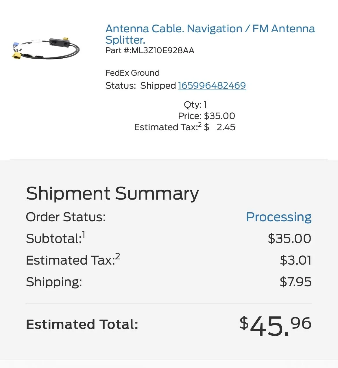

Of interest, I pulled apart my top dash and shoved my camera down in there. My radio has the mustard connection for satellite. so I replaced the antenna, bought the antenna splitter for behind the glove box and ran it to the acm. Forscan change to turn it on and I have satellite radio.
I figured it was possible without major changes, since the antenna was reportedly the missing item. Do you by any chance have a list of part numbers you used?

Just a splitter and antenna.
Ford F-150 Connected Navigation and SiriusXM force removal 59899CF1-0CB3-4B9F-8CA5-AFABD8379FF6
Ford F-150 Connected Navigation and SiriusXM force removal 94B684A0-BB8B-491A-8B8C-5166A61DE0B7

All it cost me aside from 70$ to get Forscan running was a 3 dollar antenna from a 2011 Grand Caravan at a pick a part yard.
As dhageremtp said good chance you already have Xm. Ther may be no need to buy a turner.
Just turn xm on (APIM and ACM) in Forscan and add antenna that’s it! 1/2 -1 hours work.
If you want NAV as well, a bit more to it:
Right side XM antenna
Ford FAKRA splitter (Glove box to center of dash)
And a nav unit (eBay price about 200 used)
Yes in ours eyes 200 was not enough, in fords eyes generous.
it is not installing a splitter cable
About 47$ and the price difference between non Nav APIM and Nav as well as a Non XM antenna and XM those last 2 get installed regardless.
Plus the 47 well that is retail not wholesale to Ford.
