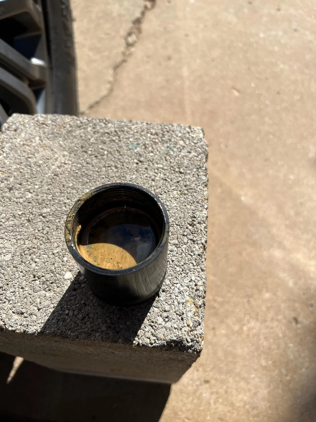

I have observed that in the wintertime in Wyoming (eg -20ºF commonly) a lot of liquid comes out. Principally water (ie it freezes) with a little oil. In the summertime almost no liquid, but some oil.
