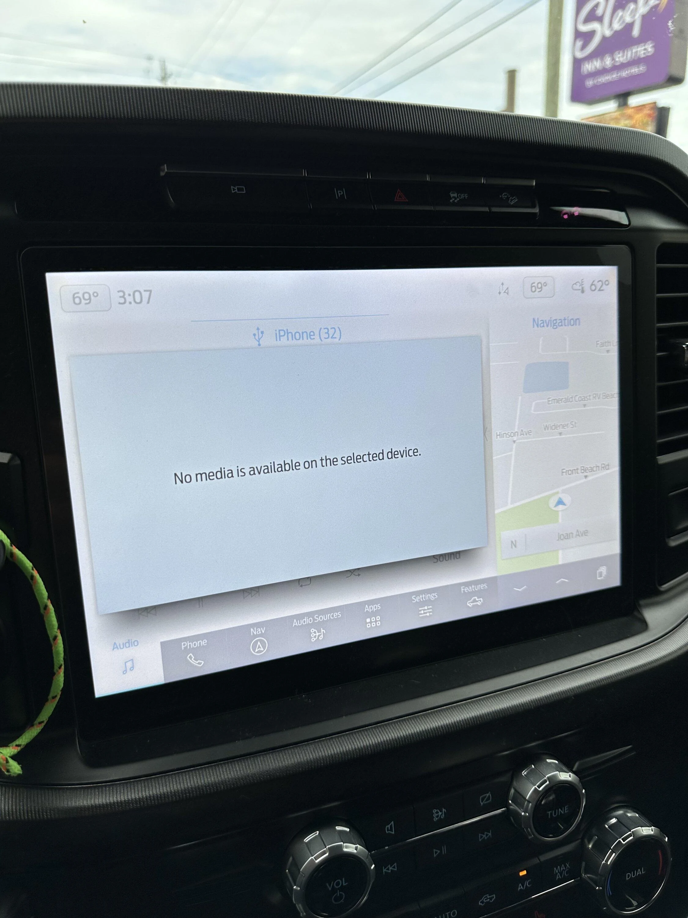

I made some adjustments today that I’m pretty pleased with so I thought I’d let everyone know.
Disconnected the center speaker. 5 minute job. Sounds significantly better not so center focused. More of what I’m used to in a vehicle.
Even though I don’t care for the app, I started using Apple Music again as people mentioned here. Switched all the streaming to lossless in the settings and I truly believe it does sound a lot better. So much that I think I’ll be fully satisfied with it once I get the sub installed. Can crank it all the way to 30 with no distortion. The midbass in the doors have good thump for what it is. My powered subs should fill everything in quite nicely. To get the true benefit make sure your device is connected via the USB cable (wired) and not Bluetooth.
I do keep getting this message though when I change songs. It pops up several times but eventually goes away and the music doesn’t seem to be affected. Anybody else see this?

I haven’t seen that. Are you still using CarPlay? Or the sync4 usb media source?
you can still use CarPlay but just leave it as a wired only connection. You may need to remove and reconnect your phone but just select the “no” option when your iPhone asks about wireless
