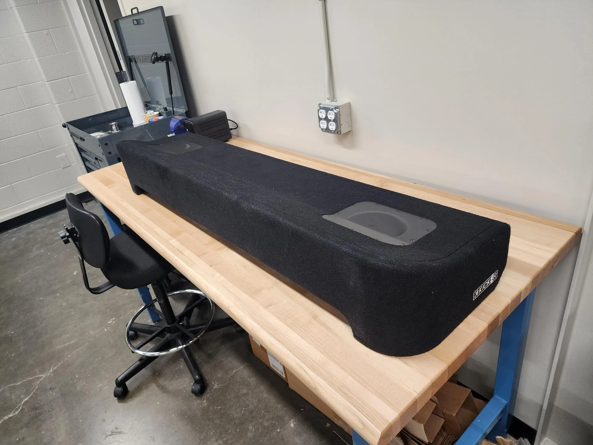

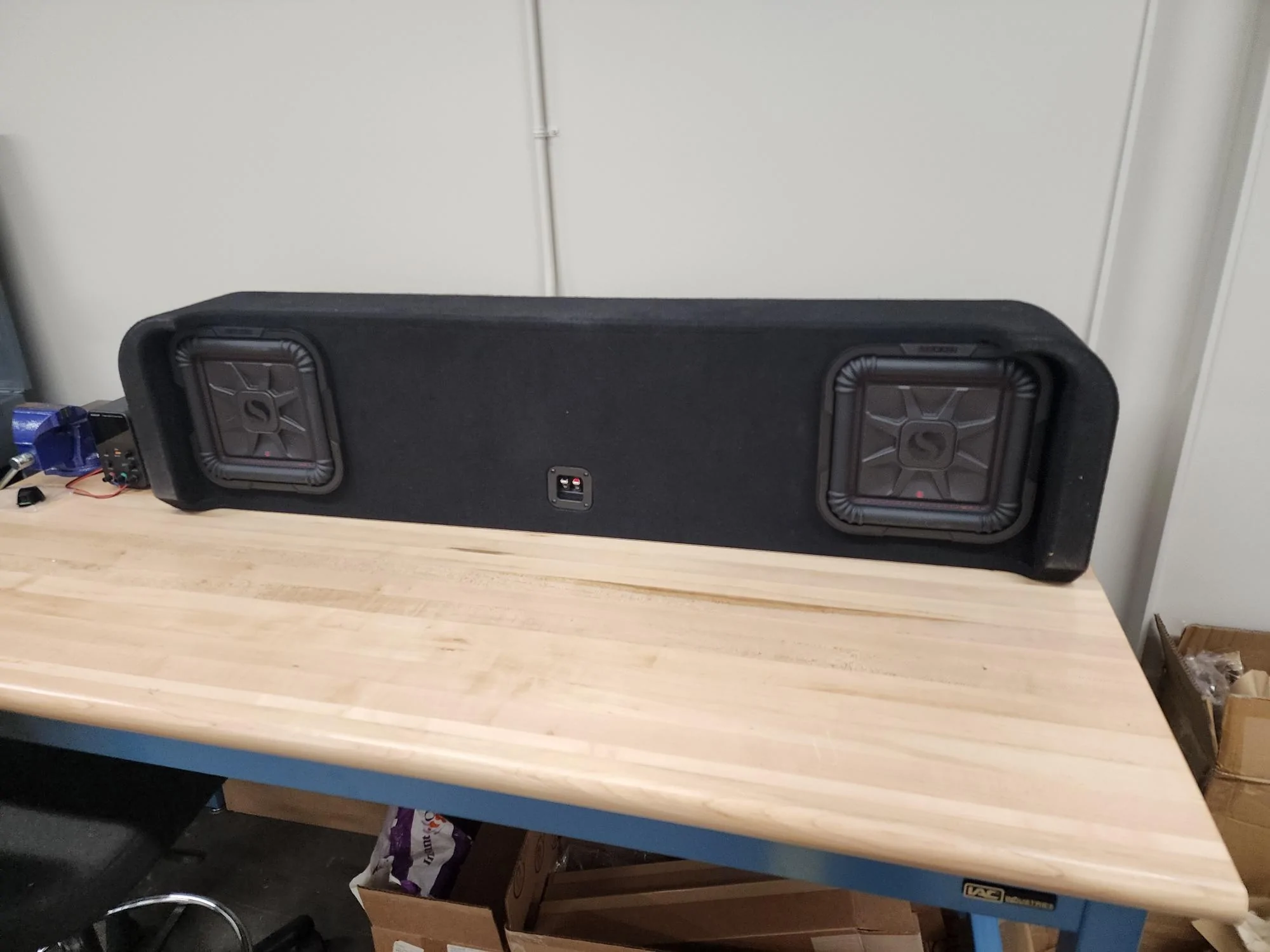

For those wanting even more bass, these will in and shipping in March. Comes with dual 10" L7T woofers. Run about $799.99
Pic of one in my truck for photos.

What amp would you suggest to power these? At what impedance? Could these be powered properly by the Kicker Key 500.1 at 1 ohm?
What is the box volume? Kicker calls for 1.25-1.75 cubic ft per sub, this looks like only a 2 cubic foot box?
Does this setup clear the two screws under the seat for those of us with the factory under seat storage bin that are left exposed when the bin is removed?
Edit: picture of the two screws I am referring to take from another forum member. Would the driver side sub hit the screws?

This looks like a great deal at $799.
That is my pic. I don’t think they would hit the screws as they’re almost flush with the top of the carpet. I ordered a Husky full mat to cover the screws and it fits over fine they do not protrude.
Thanks for confirming!

sorry been off for a week, yes the box will miss the post. I have one riding in my truck now. Woofers are high enough to give them ample room. The KEY5001 will work, but a 800.1 or 1200.1 would be optimal, 12001 would have good overhead.
