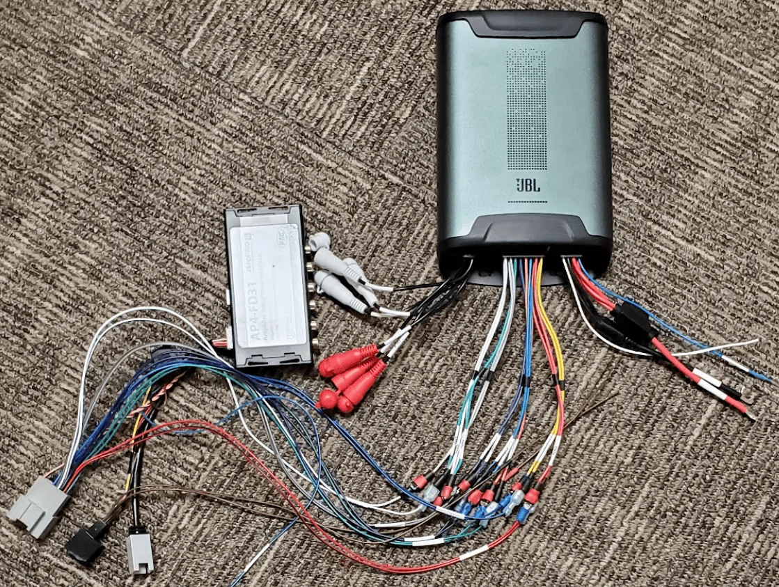

I'm hooking up the 8 channel DSP amp tomorrow to test (full EQ and timing controls). 8 channel B&O stock, w/ alpine X 6x9 woofer w/ JL C3 tweeters, C2 coaxials in rear doors, stock center channel, A2B interface box. Primarily playing, I have several DSP amps and 2 10tw3s are going in box eventually w/ a different amp. Just trying to see what the little amp can do swapping door speakers only. It's only rated 40x8 at 4ohms, but in my testing against a D5.1300, it drove the highs equally as well setup in a test room, free air, ears were hurting after ~1hr and it wasn't clipping.
See what the factory sub can do with a little more power and better speakers. If it blends okay, I'll replace the IPC center for a fill. The stock wiring is hilariously tiny. I'm destined to try and get the center as a mid fill, but if it sounds like shit it'll be abandoned.

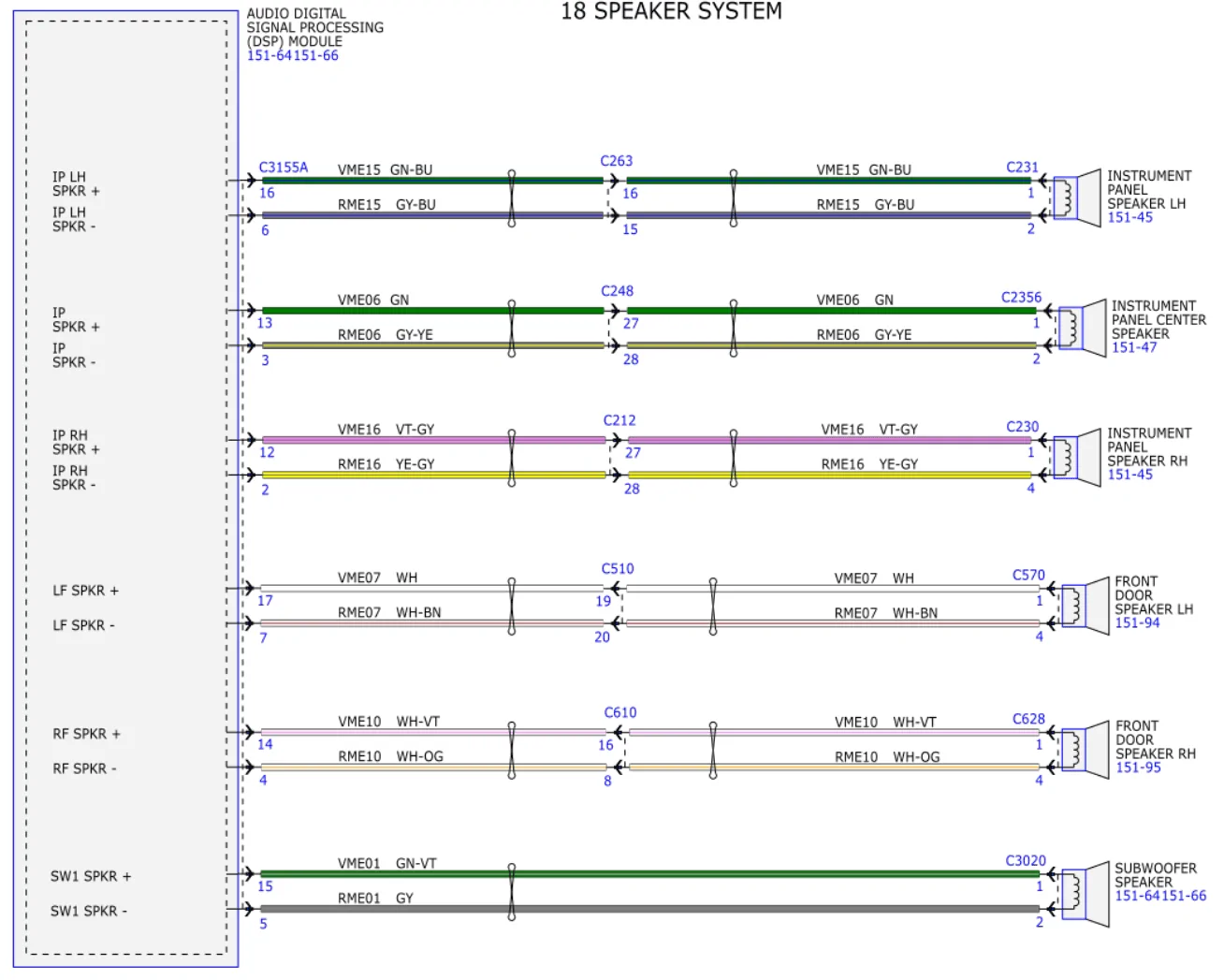

I'm following this thread. While I'm 90% happy with the magnum B&O. I'm very disappointed in the sub response. I don't need it louder by any means. Frequency response 20hz to 50 is really nice. But as it moves up to 100 to 200hz it becomes terribly muddy. Booming. Pretty disappointed in the tone controls.
I'm leaning on using a Minidsp with Room Eq Wizard .
But b4 I tear into this truck maybe you guys can tell me the basics of the unleashed system. I know there is 18 speakers, I know the sub is open enclosure utilizing the cab as it's enclosure and I know it's over thousand watts. For what ever they mean. 1000w means nothing to me.
What I want to know is how many channels are output. If there is a separate sub channel or us the sub self powered. If it is then is the input line level or low voltage.
Right now I'm only intrested in bass control.
I want to gain tighter control of the subs frequency response timing in relation to the mid to higher frequency.
At low levels the sub is superb but at even a slight increase is where it falls apart. Makes me think the sub is line level and shares its headroom with the rest of the system.
I use an expensive NAD processor in my home 2 channels system controlled with microphone measuring. I gain superb leanarity across the intire frequency range. The software measures bounce, timing, distortion and phase, the processor then calculates a frequency curve bases on my room measuments. All resulting in super tight base and excellent imaging.
The miniDSP with room correction comes in 2x2 or 4x4.
I don't know how many output channels the b&o has. I know there is separate speaker wires but how many actual amp channels?
I'm absolutely sure I can gain control of just the sub level. I just don't know if the current open sub system ford uses is going to work.
I hear the booming because of the resonate cabin.
Zyvin
Jan 27, 2021
739
998
SC
2021 F150 Crew, FX4, Lariat
In 18 speaker system, the ACM (radio) powers the A pillar tweeters and rear door speakers (rear are coax and counted as 2 speakers per side).
The rest of the system is powered by the dsp module (amp) and gets its signal via a A2B network twisted pair from the ACM. The subwoofer enclosure is vented, but to the outside of the cabin.
Therefore, the subs connector is already the amped signal from the dsp.
Spiffy
Jan 9, 2023
97
1,075
464
Usa
2022 platinum powerboost
They use the term DSP loosely don't they?
I'm my world dsp means constant monitoring.
Ok that helps. So what you discribed is other than pillar and rear door coaxs the rest of the audio is piped via can bus or a2b to the rear dsp. The data is decoded, signal, volume, balance, tone and any other injected auto into the dsp.
Inside the dsp.. how many channels? Is there just two primary? Left right?
Looking at some aftermarket car audio devices there are inline devices that can strip out certain data like audio that allows for independent speaker control.
I would prefer to tap into the audio pre of the sub then into a minidsp then separate amp then speaker.
While it's doable to take the line level out to the sub it's not ideal.
Are the rear doors the only coaxial speaker?
Other than the Pilar and rear door (6) speakers there are 2 front doors, 3 more across the dash , 2 in ceiling, 2 in head rest. And sub.
Thats a total 16. What 2 am I missing? Or is the front doors also coaxial?

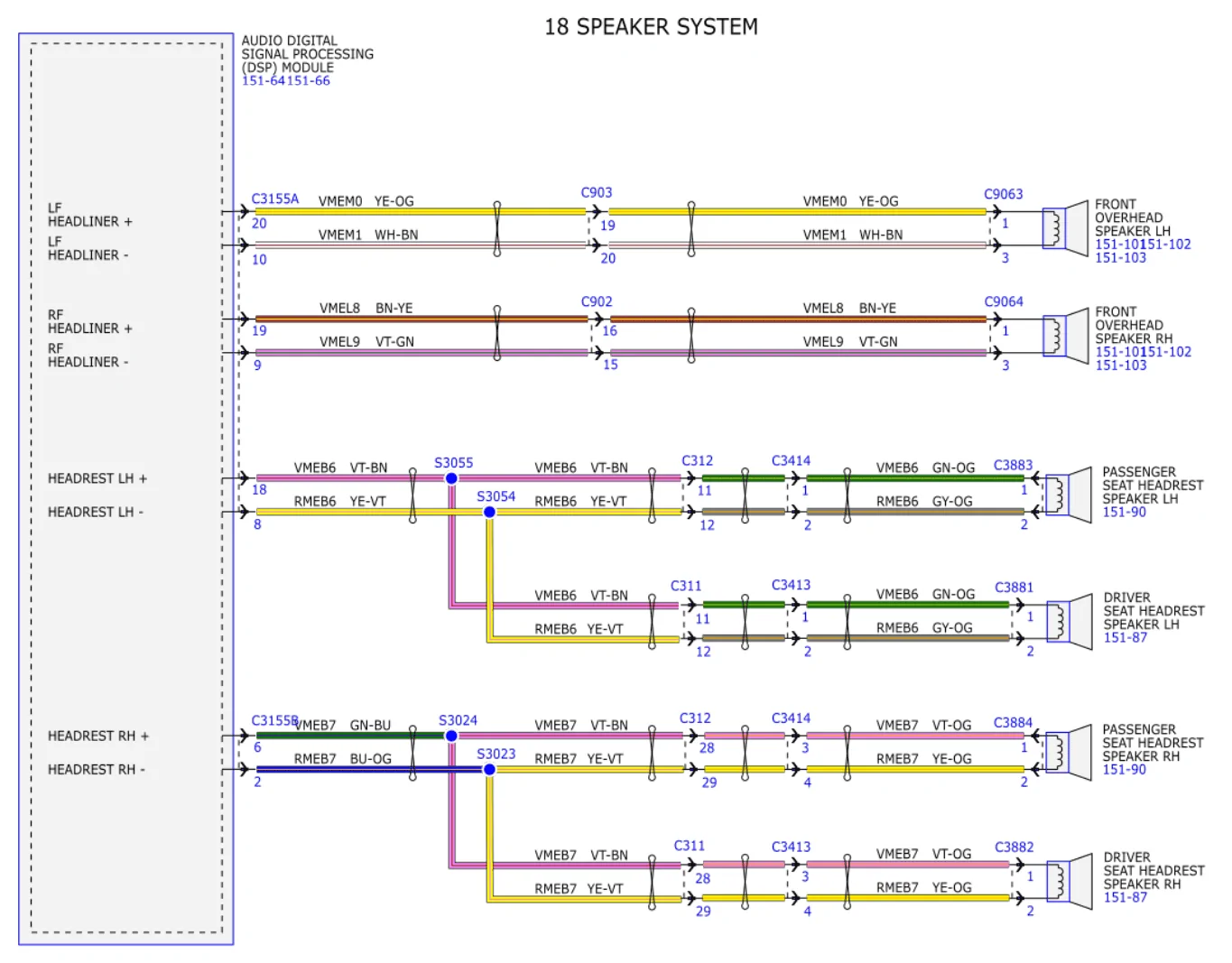

I have observed that unless I set to surround mode the head rest, three across dash and ceiling are not being used.
So it stands to reason that the dsp has only 2 channels running the rest if the system? And the sub is combined L R full with xover? If the dsp had a dedicated amp for the sub that would be tremendous. I could tap into the pre thus bypassing the internal amp. There is a ton of aftermarket processors that can be used for bass control.
Will update with more notes. The headrests have 4 speakers, they're tied together in that the left speakers in each = 1 channel paralleled, and the rights are one (basically each headrest has its own stereo feed that's shared).
The rear doors and C pillar tweeters are the same channel. So 8 speakers are 4 channels.
If you simply want to have control of the bass, it is relatively straight forward. You can disconnect the factory sub and come out of factory sub output into the Audio Control LC2i which will do a couple of things for you. It will reduce the signal to line level for an aftermarket amp, and it will compensate for the rolloff of the sub signal once the volume reaches 10-11. You would connect the outputs of the LC2i to the miniDSP, then to your sub amp.
I disconnected the sub, and the rest of the B&O is very respectable in my opinion. The sub at higher volumes is where the distortions starts to become more noticeable, but without the sub, I was able to crank it on up fairly well. The doors do need to be dampened and sealed, which will help considerably. Granted, it won't be anything like replacing the entire system, but with the right aftermarket amp/sub combo and doors treated/sealed better, it can make the factory system sound very respectable.
ACM = front head unit
DSP Module = rear amp
As for power, it's fed by a 30a fuse. Takes a lot of magic to get even 600w off a 30a fuse (such as the 8 speaker is rated for). Wiring to speakers is a mix of 20 and 22 gauge, even the "sub" is very tiny.
