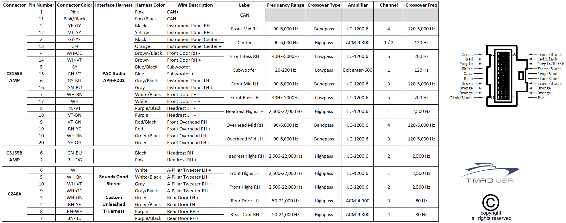

Ford F-150 B&O Unleashed Upgrade DIY Thread (Sub & Amplification) IMG_20220705_103023
Ford F-150 B&O Unleashed Upgrade DIY Thread (Sub & Amplification) 20221207_105543

I've seen dozens of threads commenting, talking and complaining about the B&O Stereo Systems available on the 2021+ F150s but none that give the information really needed to tackle a complete amplification upgrade of the 18-speaker system. I bought my 701A specifically for the OEM speaker locations and the fact the system had unique 'surround' speaker locations and with full knowledge that I'd be upgrading the system once received. There are a million schools of thought on what is the best upgrade and why (speakers, amplifiers, DSPs, Passive, Active, blah, blah blah) but over 30 years of tinkerin with all sorts of stereos I've found that the most 'effective' initial upgrade is MORE POWER!!! Even the crappiest speakers can sound great with amplification "headroom" and frequency restrictions (crossover) so my initial goal was to replace/upgrade the factory sub then add amplification (or headroom) and active crossovers to ALL of the B&O Unleashed systems other 17 speakers...

Your drawing above shows a green and red line connecting the left and right channels of the headrest speakers, are these lines indicative that the speakers are already pre-wired in parallel or series? thanks

The headrests are wired together e.g. Driver's left to Passenger's left, Driver's right to Passenger's right.
This is such a great idea - I respect your efforts to dive this deep and seek a solution for the unleashed system. how did you go about determining the speaker impedances in order to ensure your amps would handle it? or you simply made an educated guess that they would be within normal ranges?

Basically took educated guesses figuring that the OEM amp would never be capable of driving low Ohm loads. Also figured the amp self-protection capability would save me if I overloaded any particular channels. The only signals I parallel up are the tweeters/mid-range overhead and in the headrests which would low power consumers anyway...
