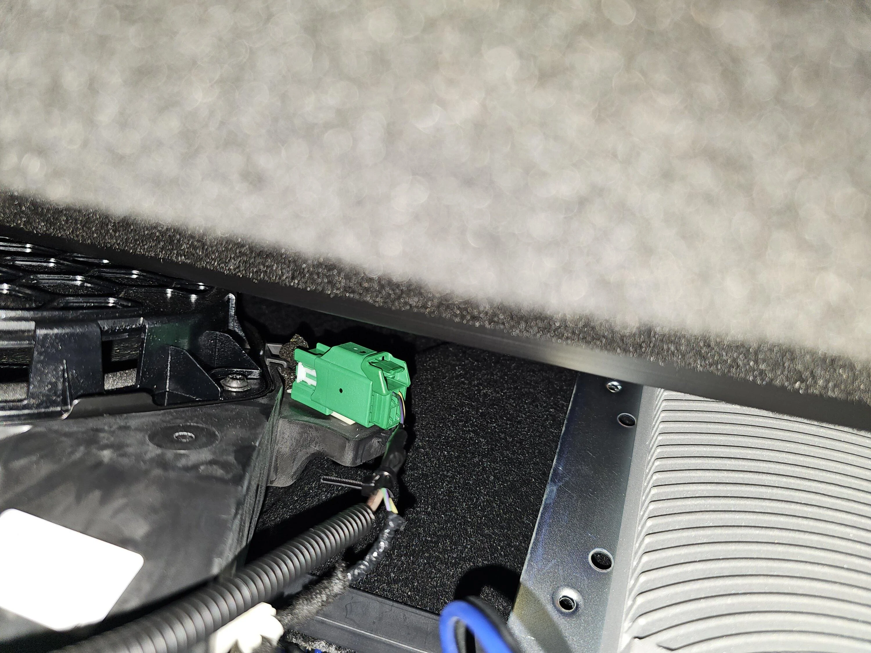

I had the audio/video shop I've worked with for years install everything. I can take a look tomorrow and see where they pulled it from. I assume they got it from the factory amp.
Never mind..... it stopped raining. This is what they tapped into. Behind the rear seat on the driver side, so yes, the sub.
It looks like most people are leaving the factory sub connected and tapping into the wire for signal. I was planning to disconnect the factory sub but I guess I'll follow in everyone else's footsteps. I'm going with the Audio Control Amp, which basically has the features of the LC2i built in to the amp. Thanks for your help!
