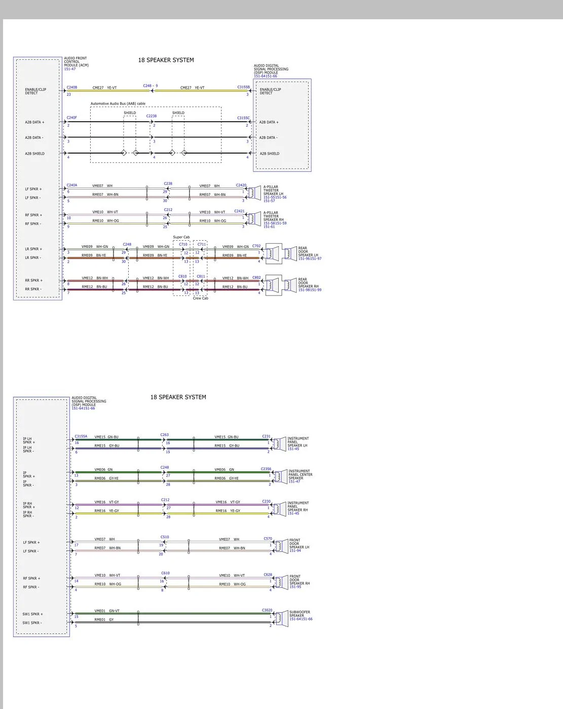

Bump for any updates in terms of where (or how) to tap rear sub/speaker channels. Do we know if there is roll off in those sub channels with volume?
Planning on installing a Kicker key 500.1 sub amp, and a JL 8" slot ported Microsub from previous vehicles.
Anyone have pics of their wiring, a schematic, etc? I haven't removed that seat yet, but hoping someone has and can share
Can we pull power from the inverter area (factory distribution block perhaps?).

Much appreciated, do you recall which channels were pos/neg on the sub?
interesting that the tweeters and rear doors are powered by the acm, and the rest by the dsp in the 18 speaker system.
