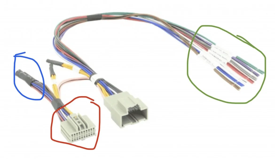

If you have the regular B&O, you can use the APH-FD02 for a no-splice connection.
APH-FD02:
https://soundsgoodstereo.com/produc...-2019-ford-vehicles-with-b-o-amplified-system
Do you have any info on how to use the APH-FD02 to create a no splice harness? I would like to just add more sound to my rear speakers just as @JJSnell did without cutting into the door speaker wires.
Red Circle- plug go into factory silver "amp"?
Blue Circle- use the rear Green and Purple wires to run to Amp? High Level?
Green Circle- run Speaker wire from Amp to the Green and Purple wires for door speakers?

The harness allows you to tap in the rear speakers without splicing and adding new speaker wires. For the 8 Speaker B&O setup.
low lever RcA to the amp then rear speaker wires from amp back to the harness.
