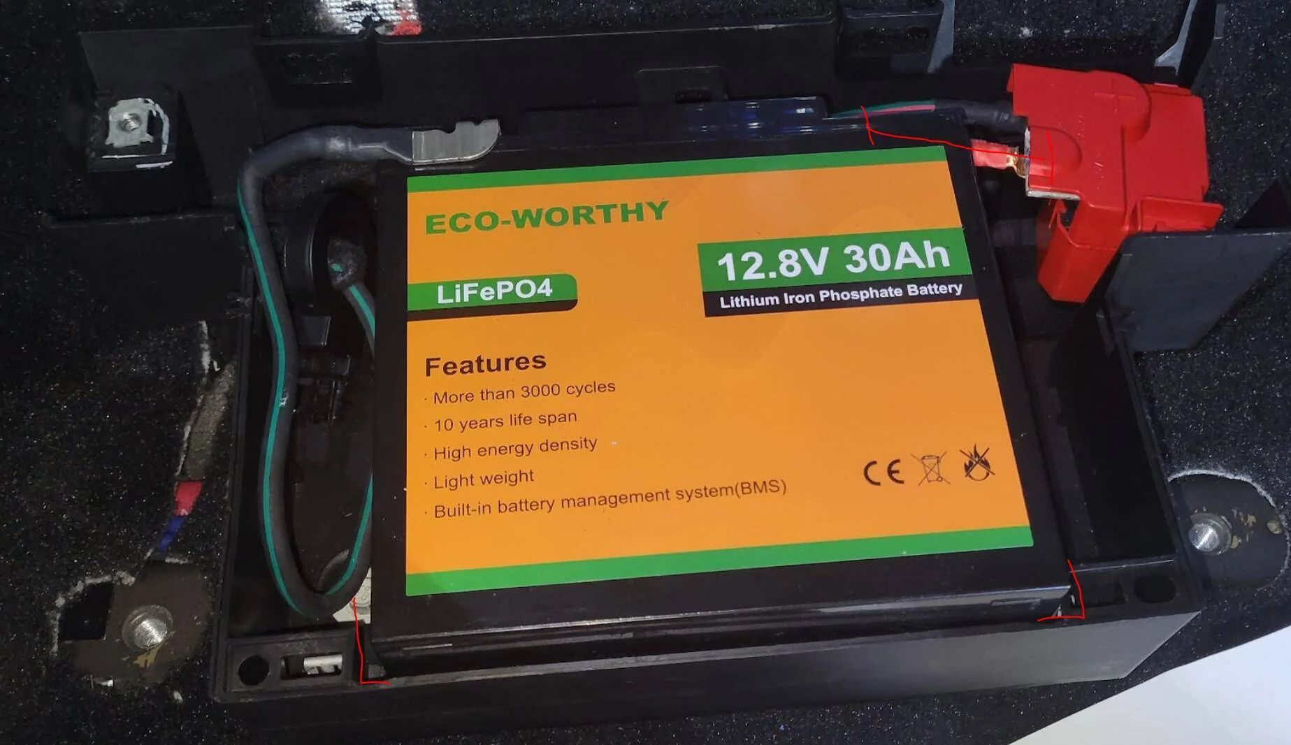

- Requires the box be modified slightly with vibratory saw (got one on ebay for $50 delivered) - lid will snap on as you're accustomed to.
- Requires a ~3" 8ga extension to connect up the positive circuit breaker assembly to the positive terminal
- my 2 batts I got required ~30ma charging for several days to fully balance the cells (will eventually balance after 72hrs, I used lab bench power supply constant current, a resistor and standard batt charger may do it.
I'd call it an exact fit post mod, like exact fit
Ford F-150 Auxiliary Battery Problem? 1733368219961-i8
I'm in.
Just a bit smaller in all 3 dimensions.
