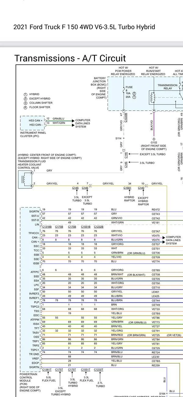

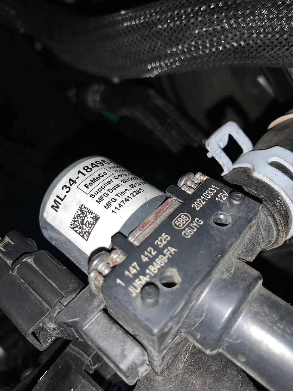

Hello, I see no one else has replied to you yet. To answer your question to my best ability. From what I’ve found that code is referring to the transmission coolant control heater valve. Located on the lower front center of the engine. It is fairly visible and accessible without removing any panels from under. I too am having this code pop up on my 21 F150 Hybrid also with the same combo of codes for the Generator torque. It’s been a few months since you posted so just curious if you’ve had it fixed yet?
