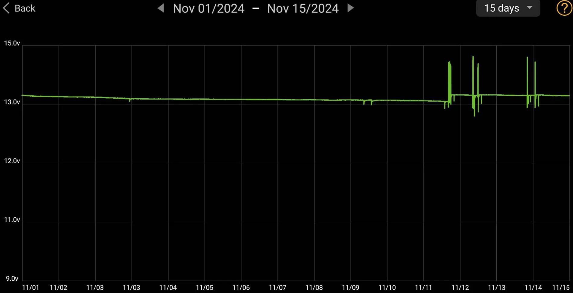

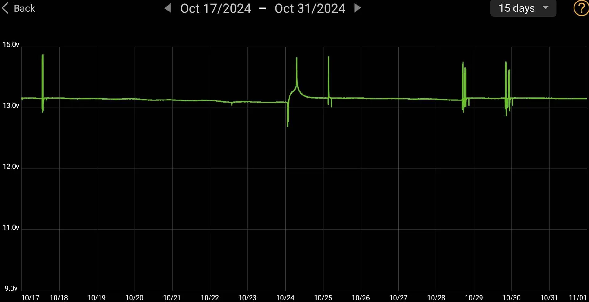

Let's check in on the aux batt...
Ford F-150 Auxiliary Battery Problem? 1733344117845-02
Ford F-150 Auxiliary Battery Problem? 1733344144989-14
Ford F-150 Auxiliary Battery Problem? 1733344178593-1y
Ford F-150 Auxiliary Battery Problem? 1733344212250-rv
Ford F-150 Auxiliary Battery Problem? 1733344258475-tm
Yeah, quite a bit of sitting. You can spot when the LFP aux batt gets out of its bulk capacity range and the under hood AGM begins to enter the picture.
I assume your LV SOC logs is the voltmeter connected to the underhood AGM AND therefore represents the voltage of the combined batteries, rather than an isolated auxiliary battery?
And if so, that LFP is "propping up" the static voltage above 13.0V for days consecutively?
That's amazing

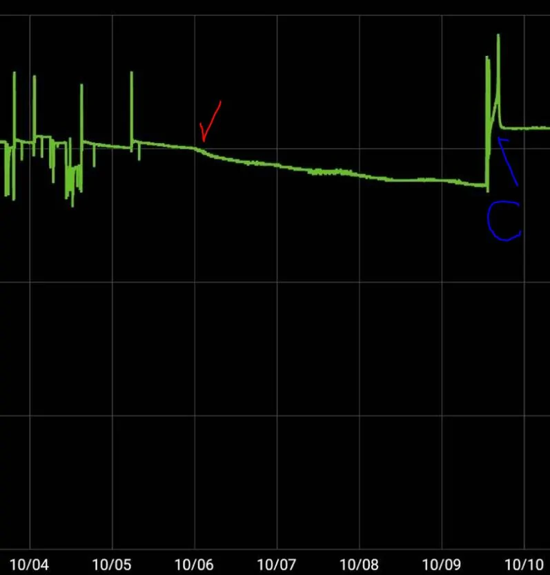

Yes, that's the typical parallel PB batt config and the LFP is 'floating' the AGM at 100% SOC until you see it sag below 13 roughly and then they're both going to 'share' the load as voltage drops (as happens on 10/6). Connected up the AGM charger that's more than enough to make the LFP happy. LFP is fully charged at 14.6v
