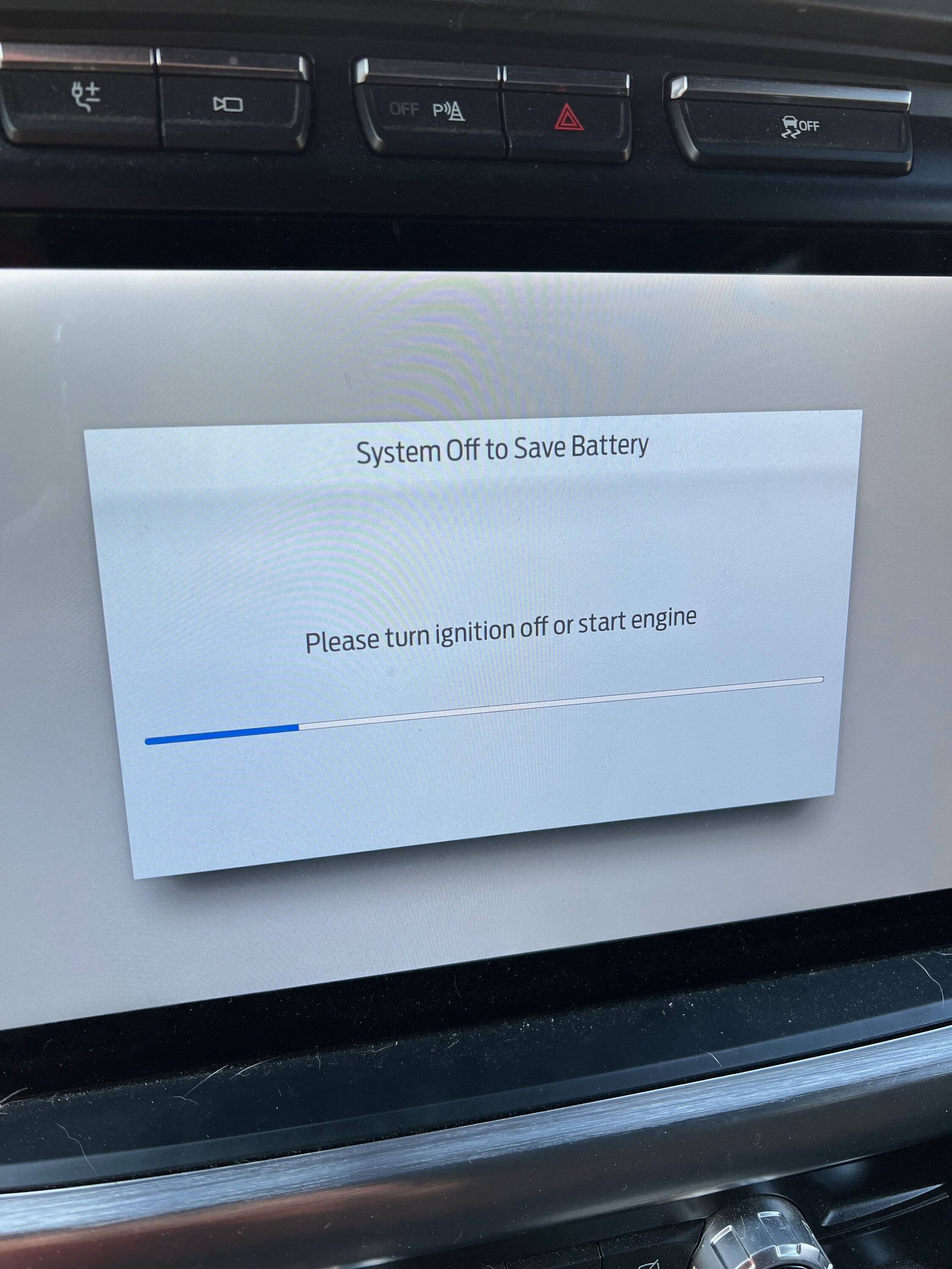

In April I was proactive and replaced the engine compartment battery with an X2. In the last couple weeks my PB has been giving me a message to turn off ignition (already off) to save the battery. Also this morning it would not start, totally dead. I put my battery charger on it and it fired right up. I think it's the battery under the backseat but am not sure. When I called the local Ford dealer the schematic shows two aux. batteries. I only found one. Is there two and could the aux. battery be my problem?

Can't say for sure if that's the problem, but my 2023 Powerboost only has a single auxillary battery
There's only a single aux batt. Could be bad -- so long as the truck isn't driving, you could disconnect the aux batt overnight to see if the issue persists. Truck fired up because it's started by the traction motor / HVB. The aux batt isn't involved in that process.

@DarrenP Just curious, did you reset your BMS (Battery Management System) after the battery change? You should after a battery change. On most newer Ford's it's pretty easy. If I remember right it goes like this:
1. turn on (not start) and note where the battery symbol is
2. flash the brights 5 times followed by tapping the brakes 3 times
3. turn off then back on and the battery symbol should flash signaling the BMS is reset
I think that's it. Doing this can get rid of many module gremlins.

Thanks for the information. I did reset the BMS when I changed out the engine compartment battery. When I changed out the aux. battery I also reset the BMS even though I didn't get the battery icon on the dashboard like I did when I changed out the engine compartment battery.

I've now replaced both batteries and am still having the same issue. I also disconnected the engine battery and charged it for an hour. I've made an appt. with the local Ford dealer since it's under warranty.

i just replaced my auxiliary battery today with an OEM replacement from the dealer. $75.
i reset my BMS and I'm still getting the same warning on the screen, Also, many little features like approach lighting and radio and interior lights shut off immediately after turning off vehicle.
i tested the 12V engine battery, and it's showing still good.
... I'm perplexed... i hate technology when it doesn't work, lol
